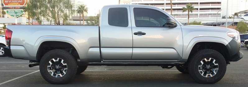

    Yeah the alignment showed that I had some toe-out, and SAI / Included angle was a bit off of factory spec. Bizzarre bump-steery like feeling went away after that. Lesson learned: ALWAYS do the alignment even if you marked the eccentrics.
    Here's a pic from the other day, again, I'm on 265/70R16 Falken Wildpeak AT3Ws.
    Same here, I was stumped but I measured and re-measured a number of times! My guess is this: Leaf spring is what pushes up, shock is what "pulls" down and damps movement. The Bilstiens are "softer" at rest and pull down with less force @ static height and no load. Thus the springs are allowed to push the truck up further.
    As far as I know the chassis itself is configured exactly the same across models, and the only thing different from this truck VS a stock TRDOR would be the 1/4" spacer, which Toytec said would not require bump stop shims. I will probably be installing wheeler's off road bump stops at some point so I will check then.

  6. Dec 30, 2016 at 11:43 AM
    #26
    ExplorHer
    ExplorHer Question Authority
    May 2, 2016
    #185889
    822
    Near Pittsburgh
    2016 4cyl, 5MT, 4x4, 2 seats, dents, & rust
    TRDOR Take off coils and Bilsteins with a 1/4" spacer up front, Bilsteins with original leafs on the back, and wheels and tires.
    Sliders, skid plate, and rear bumper weighing it down.
    I did not take any measurements.

    That, plus I think I got some extra because I'm a prerunner, so no transfer case and diff up there either.
    Uhh I always mix up the backspace and offset. 0 offset so... 4" backspace?? But yeah, the F5's are awesome. I love 'em.
    http://toyteclifts.3dcartstores.com/TP14--Front-Top-Plate-Spacer-One-14-thick-spacer_p_351.html order 2 of these.
    Ride is exactly like the TRDOR. Leans more in corners, but is less jolty off road.
    No, what I did was used a "lean" spacer on both sides to give it just a hair bit of extra lift without incurring the wrath of normal, larger spacers. Didn't even need to install longer studs. No lean in the front at all.
