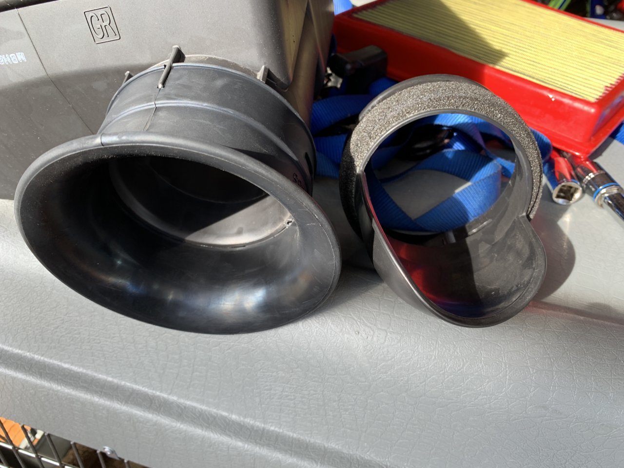

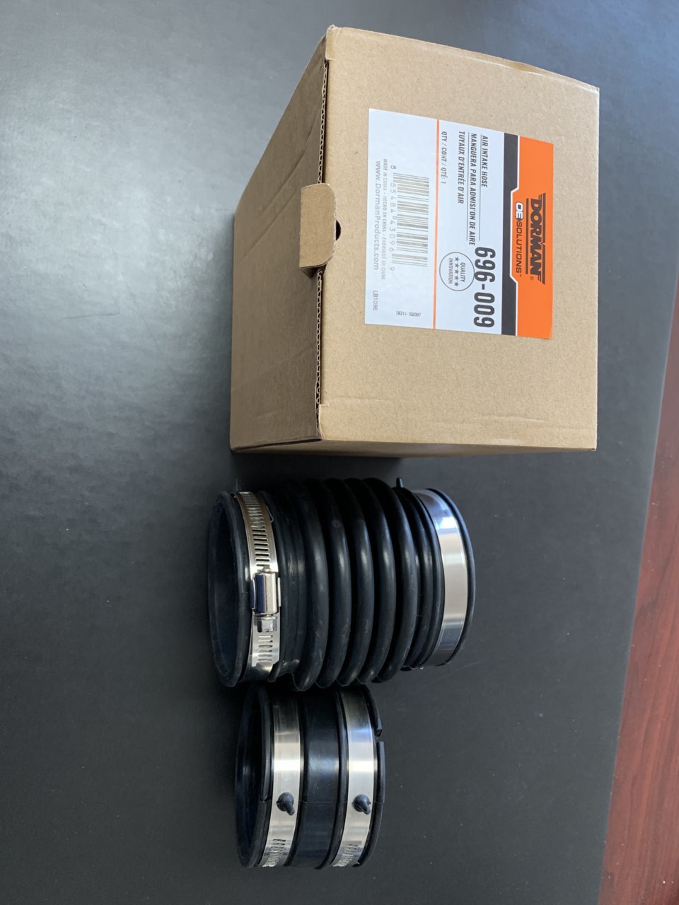

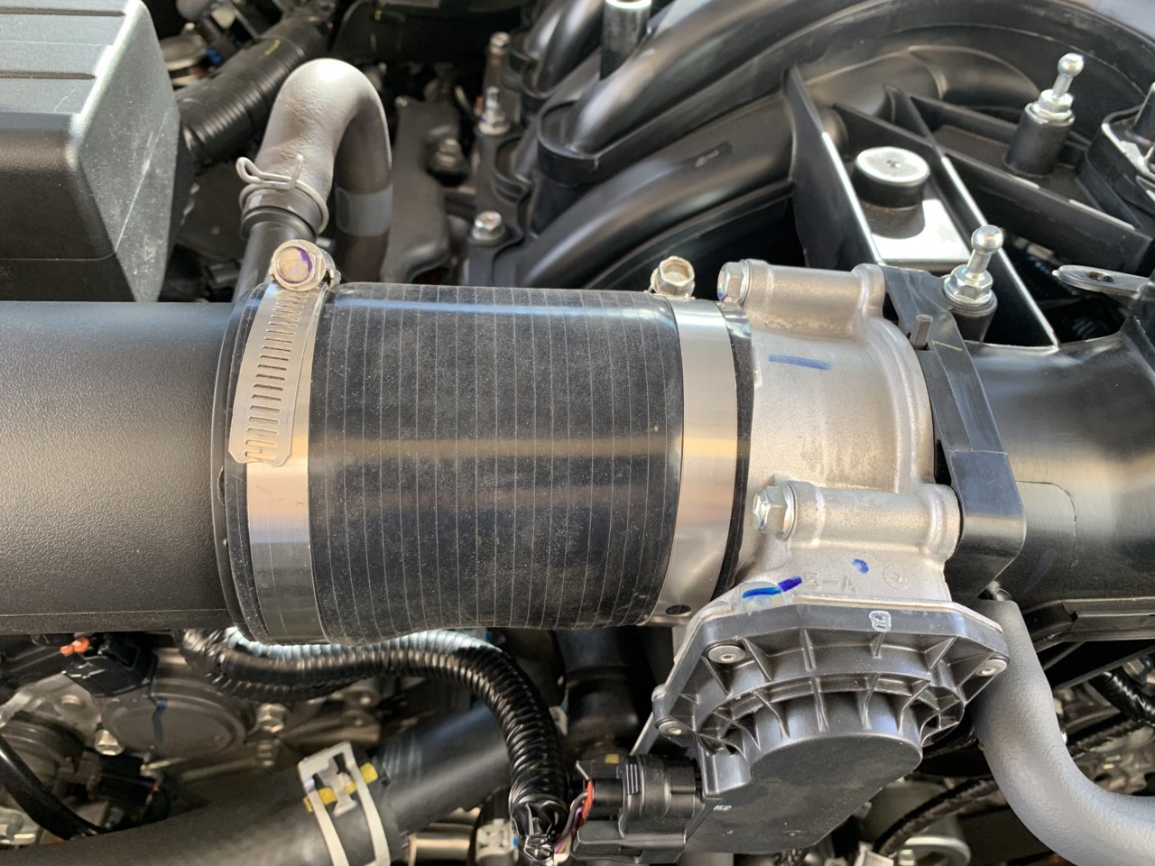

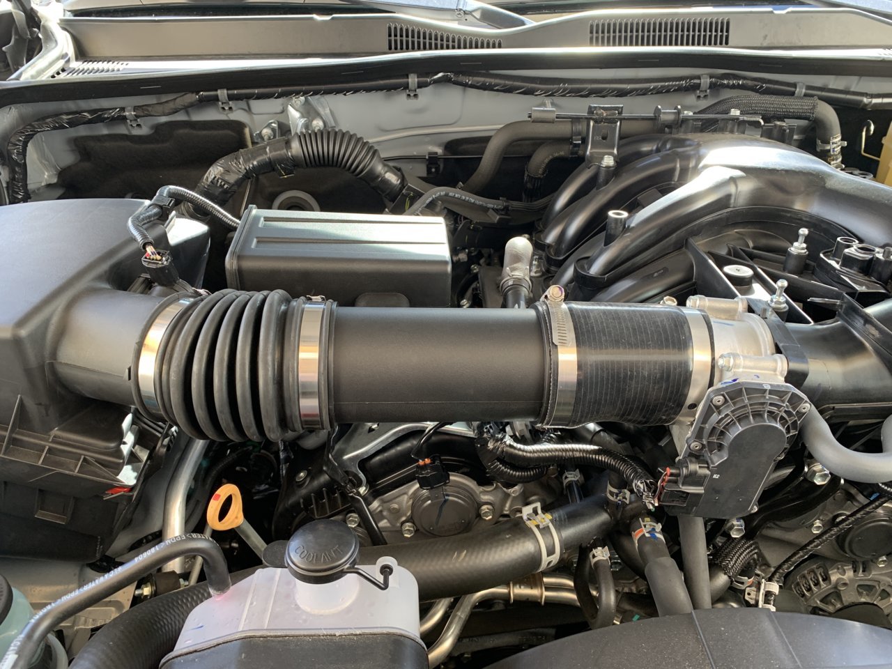

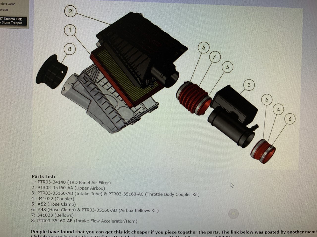

    I know, I know, I cheaped out and didn't get the TRD intake when it was on a 40% sale (I did get the bunch of other goodies though, including TRD exhaust), I also don't think that the TRD intake is worth the premium ($360.00+) so I decided to make my own intake that can perform just like the TRD but at a much lower price while looking factory.
    Before this thread goes ape sh!t, I did NOT do it for the performance, I did it purely for the sound to complement the TRD exhaust :cool:
    Parts needed:
    1- Intake flow accelerator (Dealer): PTR03-35160-AE, $22.00
    2- Intake tube with resonator (Dealer): PTR03-35160-AB, $56.00
    3- TRD Panel Filter (Dealer): PTR03-34140, $35.00 (TRD sale price)
    4- Dorman 696-009 Air Intake Hose (Amazon): $29.95 https://www.amazon.com/gp/product/B078SWRV2J/ref=ppx_yo_dt_b_asin_title_o07_s00?ie=UTF8&psc=1 (You won't be using the smaller piece).
    5- 3.25" diameter inlet/outlet straight intake hose (Amazon): $15.67 https://www.amazon.com/gp/product/B00GX2AWSO/ref=ppx_yo_dt_b_asin_title_o03_s00?ie=UTF8&psc=1
    The install is really simple. The most important thing is to cut the silicone hose to 12cm in length, the rest is self explanatory. Unlatch and remove the air box cover, unscrew and remove the air box, remove old and install new air horn/accelerator, reinstall the air box, install TRD filter. Detach and remove factory hose/resonator from the air box cover and throttle body. Assemble all new pieces together (Dorman hose, TRD resonator and the silicone hose), secure the assembly to the throttle body then reattach the air box cover. Use two Dorman clamps and reuse two factory clamps to assemble all of the pieces. Done!
    So, for roughly $160.00 (or possibly less if you shop around) one can enjoy crisp sound of a TRD intake without the Toyota's red bling bling price :thumbsup:

    It looks like Amazon seller ran out of black silicone hoses a few hours after I posted this thread, lol. He still has some blue and red ones though, or you can find another seller. The most important thing is to make sure it's no more or less than 3.25in in diameter. Anything larger will be too large for the throttle body, anything smaller will be too small for the resonator, so 3.25 is a perfect size to accommodate both ends.
