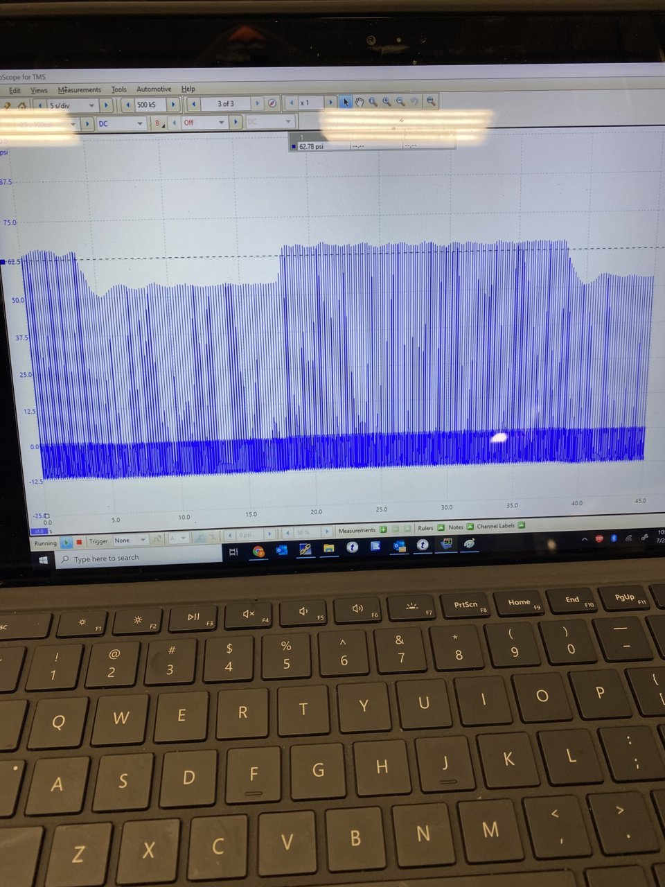

    I mean, I feel bad for you but I think you want to act like this isn’t isolated so you feel more supported and can commiserate. I also have a buddy, he’s a master tech, manages the largest Toyota shop in WA and is a Toyota appointed/trained fixer for the westcoast region.
    I sent him your post and he responded that early on they saw a few cases where the seats dropped and lead to failure. He said it is almost always recognized first by the cylinder imbalance code that you experienced. Now, he sees nearly all of the problem cases that the region uses for program development and said this is no where near large enough to constitute any type of official response, or even a behind the scenes approach. The failure rate per units sold is simply insignificant.
    here’s a sweet visual of a failure case using a cylinder pressure transducer:
    I hope you get it fixed up and I really feel for you, man!

    Gotta love the picoscope. I wish I had more context or a pic of a known good.
