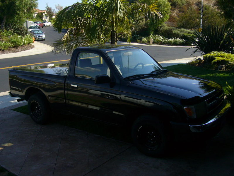

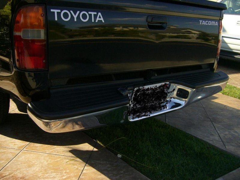

    Someone on their cell phone rearended me today. It's not that bad but it still sucks. I guess this would be a good time to paint the bumper black. What's the easiest way to paint a bumper? And will it last?

    damn that bumper held up good. i would take a bumper like that then the body getting damaged. thats probably an easy fix. good luck :thumbsup:

    Powdercoat your bumper.It's way more durable than regular paint.

    that looks good. This might sound stupid but can you buy powder coat in spray cans?

    No you can't. Easiest way is to take it to a powder coat shop for them to do it for you. They have the right equipment. You can buy a home kit and set it up like this:

    rustoleum flat black looks good too (though on a black truck maybe not so much)... i just did my rear chrome bumper. roughed up the surface slightly with some 150-grit sandpaper, cleaned off any surface rust with a wire wheel, then primed, painted and reinstalled. nothing to it.
