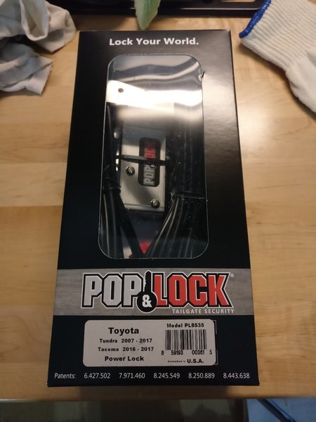

    You want the Pop & Lock PL8535. It says for Tundra but works just fine. Never been to their website so don't know what options you're talking about. Got mine on Amazon.

    Pop & Lock PL8535 Power Tailgate Lock for Toyota Tundra https://www.amazon.com/dp/B00LST3022/ref=cm_sw_r_cp_apap_ahaiqDowbNyow
    It is PL 8535, even though it says it doesn't fit Tacoma, it does.

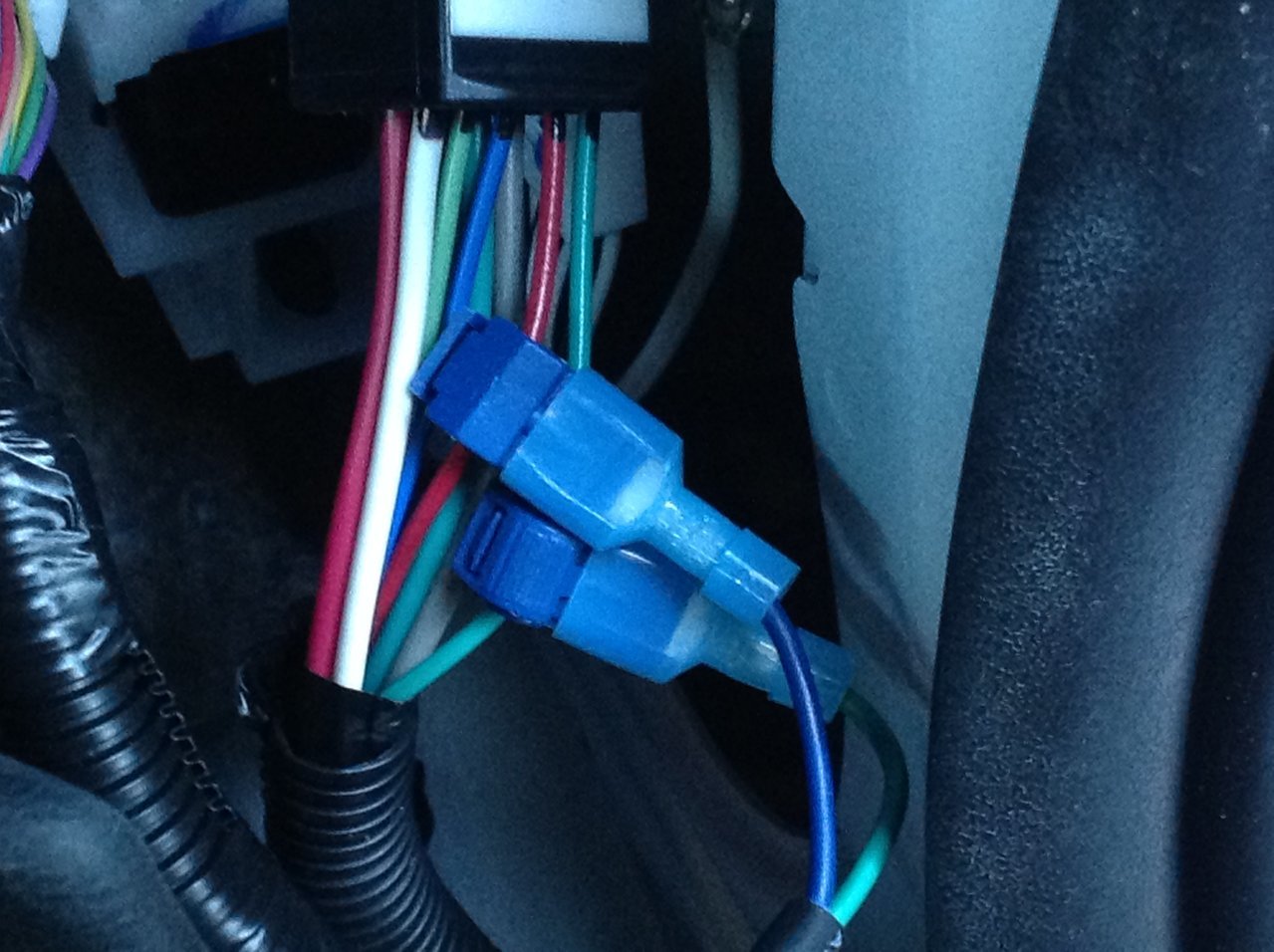

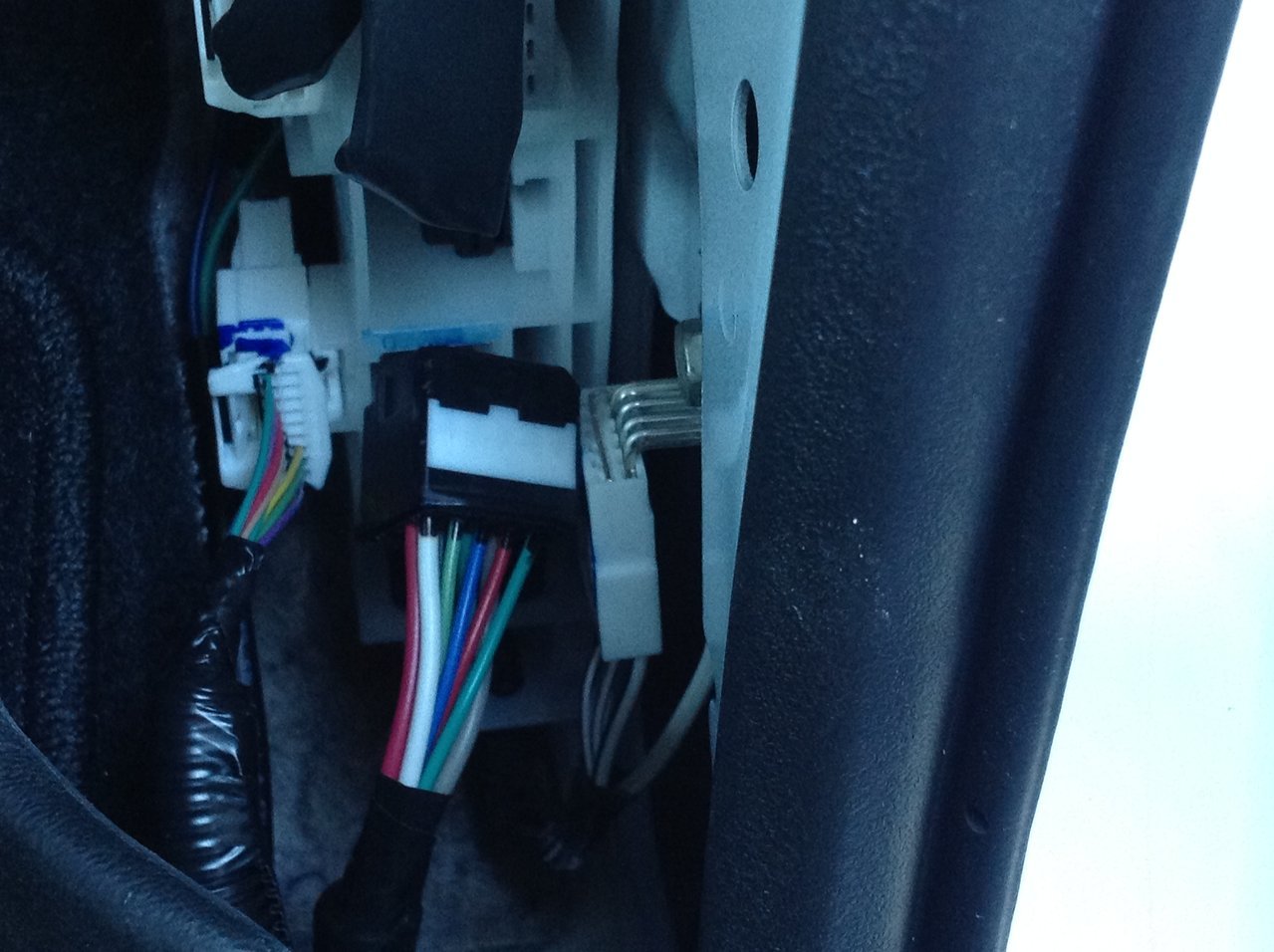

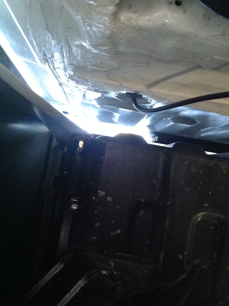

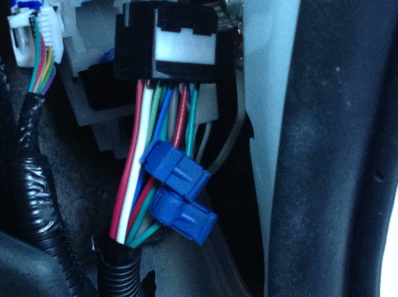

    Yup installed mines today and went along the passenger side.
    I also found a rubber plug (grommet) between the bed and cab near the corner. That was easy to remove and allowed me to drill a hole though the plug and pull the wire through. Then re-inserted the plug. Its water tight. The photo below is looking up from underneath.
    Then pulled the wire to the front passenger and removed the kick panel by the front passenger side
    Pulled the lower black connector.
    Added T-taps to the smaller red and green wires (the last 2 wires on the right side)
    Then inserted the wires connector. Like everyone said, green to green, blue to red.
    Done, now it locks with one push of the fob, and unlocks with two. I set my truck to open just my driver side door with one and all the doors with two clicks. The Bestgle T-Taps are easier to work with like the posi-tap, but cost much less.
