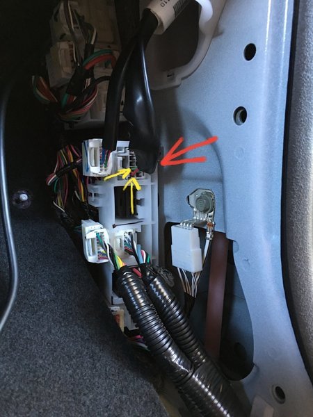

    20180413_232846.jpg Hey so I just did this mod on my new 2018 DCSB trd sport and it worked out great. Went through these pages a few times to figure out what wires to tap into. I tested the actuator first before installng it. I just stripped the blue and green wires and touched the pink and green in there connectors and hit my lock button on my keys to see it working. Very happy with outcome.
