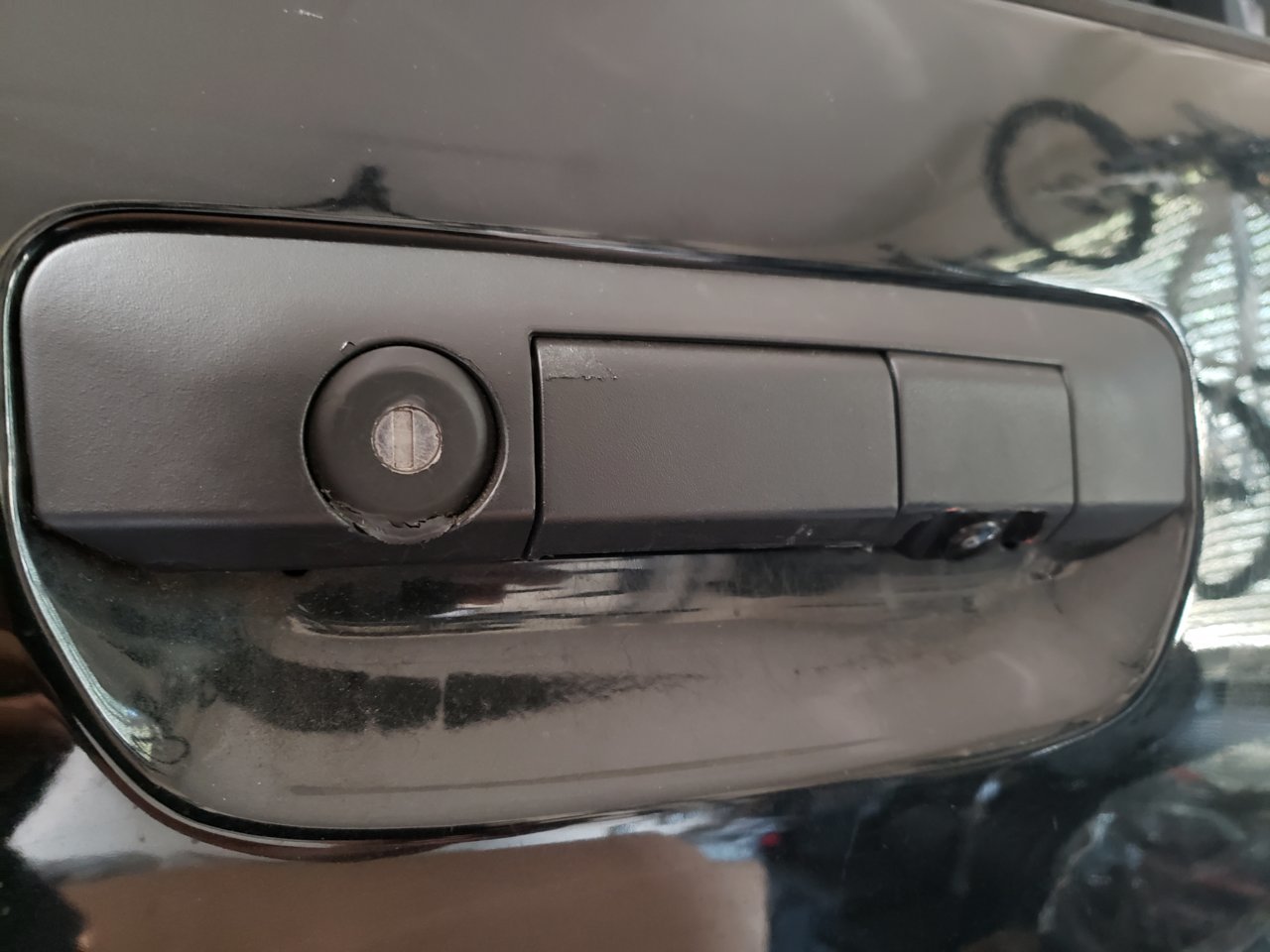

    I have a manual pop and lock handle on my tailgate, 2008, got it off eBay and keep the key in center console... works fine and I like the set up.

    I had a pop and lock and it worked fine for a while then started jamming. Maybe dirt caused it. I'm not sure. Never got it to be dependable so I ended up going back with the one that came off. I searched for some other brands. I found one but lost interest and never ordered it. For those that have had p and l and had good results.... great for you. But that wasn't my experience. Good luck.

    I’ve had the manual version for about 8 years. Works great, no problems. I’m old school and prefer the manual version. Just seems to me like there is less chance of something going wrong with the manual.

    Had a P&L I bought a few years ago with bolt technology (so I could use my ignition key to lock and unlock the tailgate.) No power controls though.
    From the start it didn’t have a crisp opening feel to it like OEM. I verified 50 times to ensure installation steps were as followed and even tried alternative orientations etc.
    It seemed like the handle itself preferred me to push in on the tailgate in order to get a good and clean release.
    The plastic handle is kind of janky and has more flex than the original. Cheap quality.
    The icing on the cake was when the regular black trim finish faded to white. I took care of it too and used proper sealants safe against fading on trim specifically.
    It’s currently off with the original back on. I may end up repainting or reordering in hopes quality has changed. Maybe I’d have better success with a paint matched lock this time.
