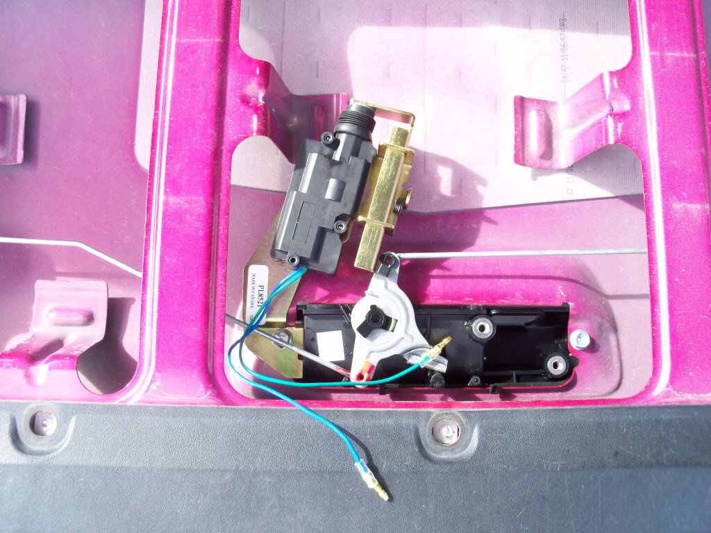

    The 8521 install is really easy. I was a little worried about finding the wires, but I found them on the first try. The little grommet was also no big deal - I just ran the two wires (not the bulky black outer wrap) through the grommet/plug and put a big glob of silicone over the wires, using the black outer wrap on both sides of the grommet. My only other suggestion is to buy some extra wire connectors and shorten the wires in the tailgate and where you tap in on the passenger side for power.

    The electric one closes fine when locked. It just prevents the handle from moving and pulling the metal rods connected to the latches on each side.
    http://www.tacomaworld.com/forum/audio-video/77521-pop-lock-8520-8521-guide.html
