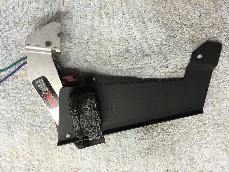

    Before we even ordered the locks we got the additional bracket from TacomaTruckParts.com , well worth the money. We then purchased the PL8521 from Amazon, ours came with the foam block on the bottom but we had to remove that and then attach it to the additional bracket:

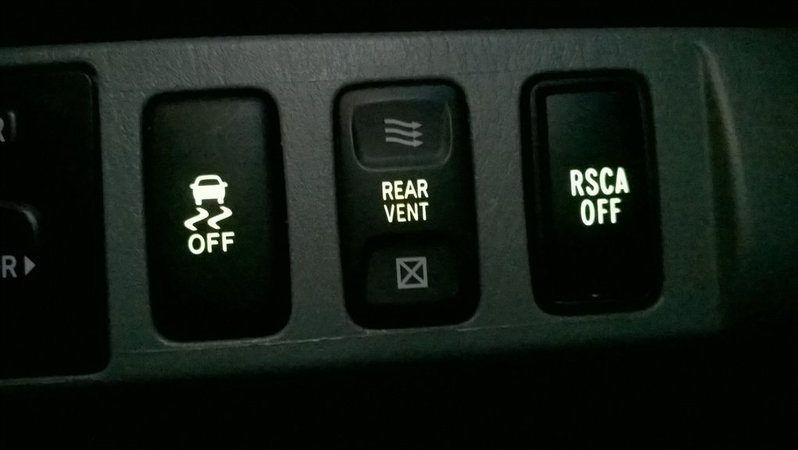

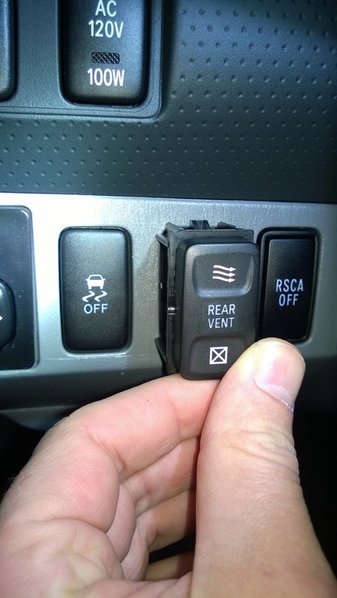

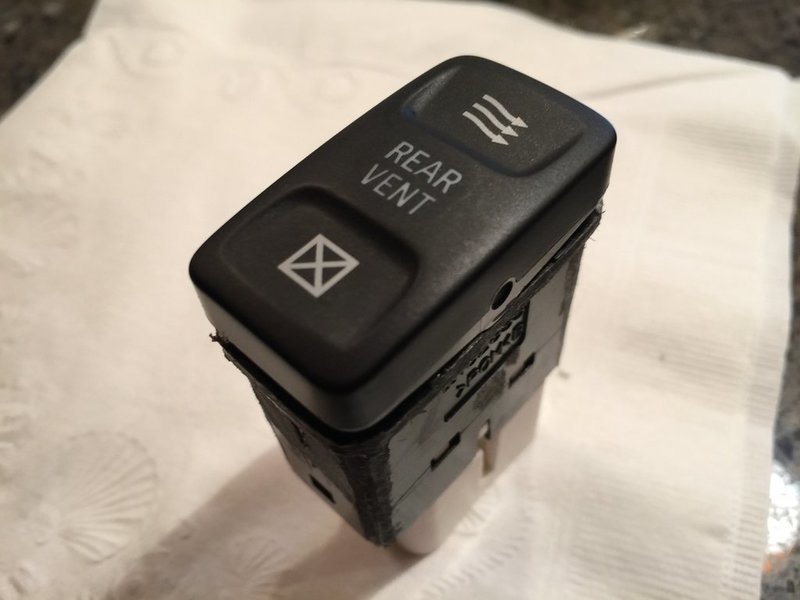

    We then did a lot of researching and buying of switches but none had a factory look so we ultimately landed on Toyota part number 84835-AE010 that we found referenced in the power rear window mod. The only downfall is that this switch will not fit the factory dash without trimming both the switch and the dash:
    Switch prior to trimming:
    Switch after trimming:

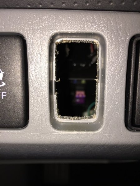

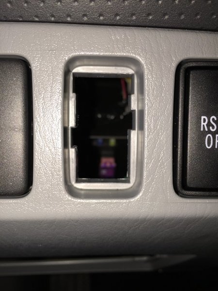

    Dash prior to trimming:
    Dash after trimming:

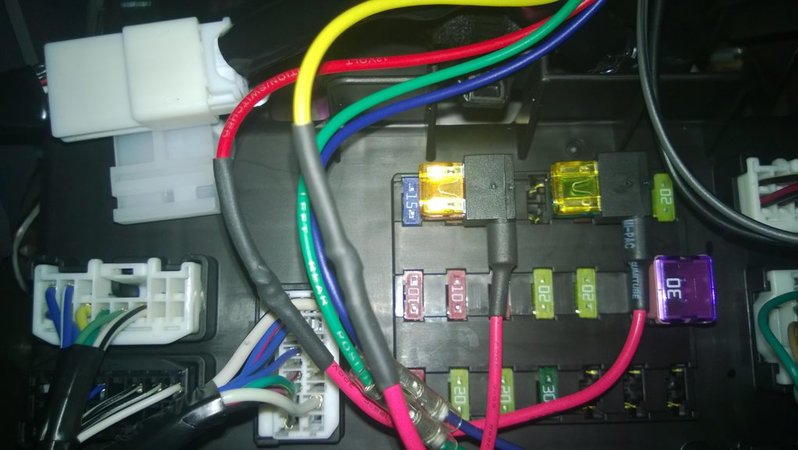

    We used 2 add a fuses on the harness and tied into the "TAIL" fuse for the switch lighting and the "PWR Outlet" fuse for 12 volts without needing the key in the ignition:
    Harness installed:

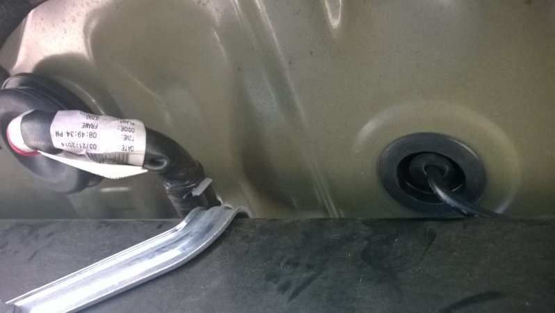

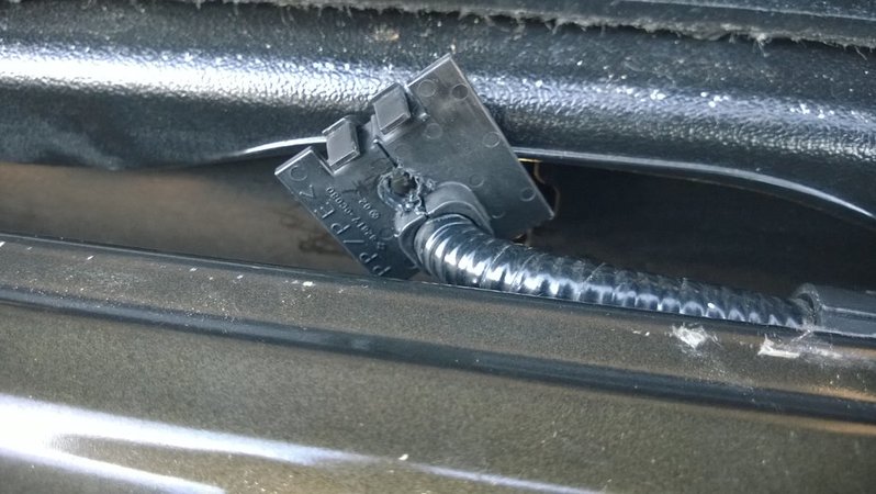

    As far as the lock wire routing we did have an issue I hadn't seen discussed on this site (may have missed it), we had to drill a 1/4" hole in the plastic bulkhead connectors where the factory camera wire passes through:
    This allowed us to follow the factory wire bundles all the way up to the drivers seat where we used a small body plug with a 3/16" hole to get the wires into the cab. The hole is undersized so no RTV is needed after the install (tighter than a knat's ass over a wine barrel):

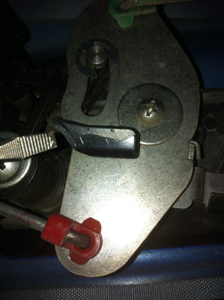

    Here is the piece that broke off on my Pop and Lock. Yeah the OEM one is plastic too. Well Im sure the OEM one is made from a harder plastic. My OEM one lasted 4 years. Pop and lock lasted 1 year. Piece of shit.
