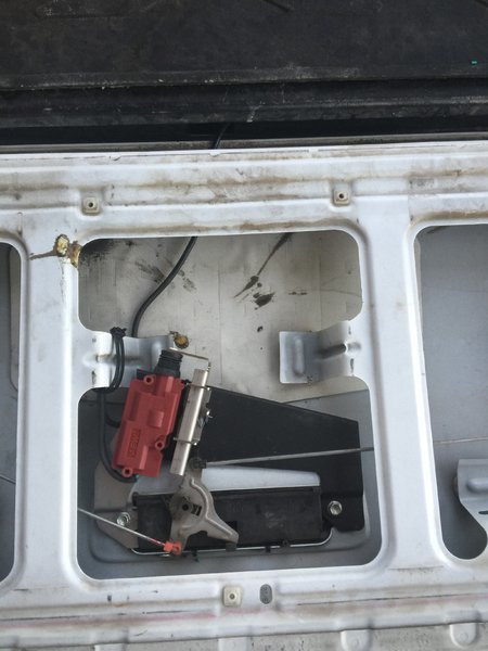

    Thank you to all of you for your input into this project
    It took me some time but I did it.
    For my 2008 DC Sport I tapped into the blue /pink to green and blue / black to the blue.
    It seemed slow to work at first and then I started the engine turned it off and then it worked.
    Reversing the wires made it unlock and lock with or not with the car doors

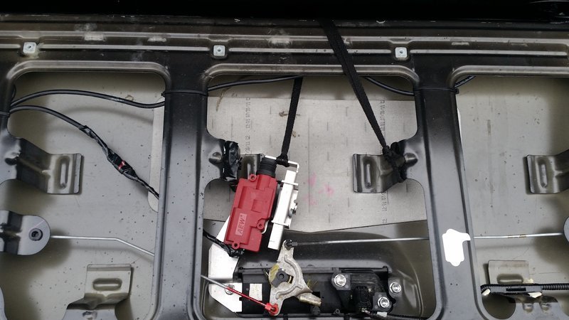

    Finally installed the Pop N Lock PL8521 power tailgate lock today. I spent way too much time with the installation as I wanted to run the wires a certain way but since I couldn't get the pins out of one of the connectors I had to modify my plans. The install turned out looking clean and I added an emergency release in case of failure in the locked position.
    Here is a picture of the installation:
    8BF9EFDE-C153-4C4A-AC01-0654C8EA113E_zps_0911c2e3f362e1006e3f0eb53e6d838c983e6bd3.jpg
    And here is a link to more details in a thread I started about the emergency release.
    https://www.tacomaworld.com/threads...-with-emergency-release.445898/#post-13015374

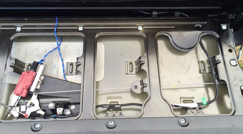

    Thanks to everyone here for this thread. I picked up a Pop & Lock on a black Friday sale 50% off. I did lots of reading on the tips tricks and issues with this unit and now I feel I did a good installation hopefully without any problems down the road.
    First I started in reverse wiring from the inside back. I popped out the grommet and actually drilled a small hole in it instead of slicing it allowing it to self seal around the wire.
    Second good top was use the existing camera wire holes for your short harnes.
    Third. I had to add a block to stop the pop and lock from being able to be moved by pulling the handle really hard.
    Fourth. I put some thread locker on the 10mm bolt.
    And fifth I added the failsafe.
    I am extremely happy with this set up as I carry tools In my truck and am often very worried about them. And I travel on the ferry quite often leaving valuables in the box..
    Thanks agan for everyone's input and help.
