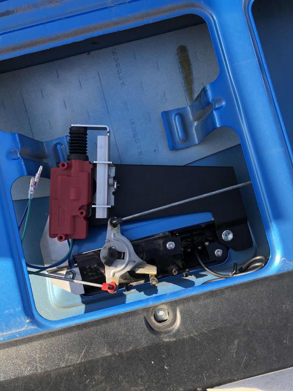

    Finally got around to installing mine today on the 08 just gotta run the wires for the lock and backup camera, I also installed the additional support for the poplock

    Had issues with the PnL 5400's (manual lock) cantilever snapping after 2+ years of use. I should have just went with the 8521 initially. More work to install, but definitely worth it. It's only been a few hours since I've installed it, I hope it lasts 10x longer than the manual version. It feels like the value of the truck went up at least $5,000 with this auto lock installed. For those who own a non-3rd gen Tacoma, I would say that the 8521 is a must-have.
    BTW, thanks to all the threads on the forums that provided guidance on the installation of the 8521s. Your write-ups surely made things a lot more clear to a noob like me.
    My install:
    Zip tied cable to frame
    Used the hole under the passenger side seat
    Left quick-release connector outside of tailgate
    8521 unlocks with passenger door

    Just did this over the past 2 days. Tied the rip cord just in case the locking mech fails. After watching a few videos it took me about 45 minutes total to do this, and I took my time and continually double checked everything. Excellent mod that I think every one should do, especially for the money.
