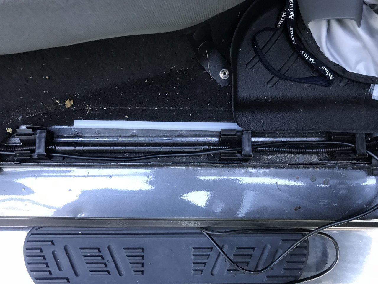

    decided to go different route myself (Someone suggested it somewhere )93477C3B-3551-4A4B-9785-85C94B6118EC.jpg
    It took me a bit more time taking off the storage behind the seat but it was totally worth it!

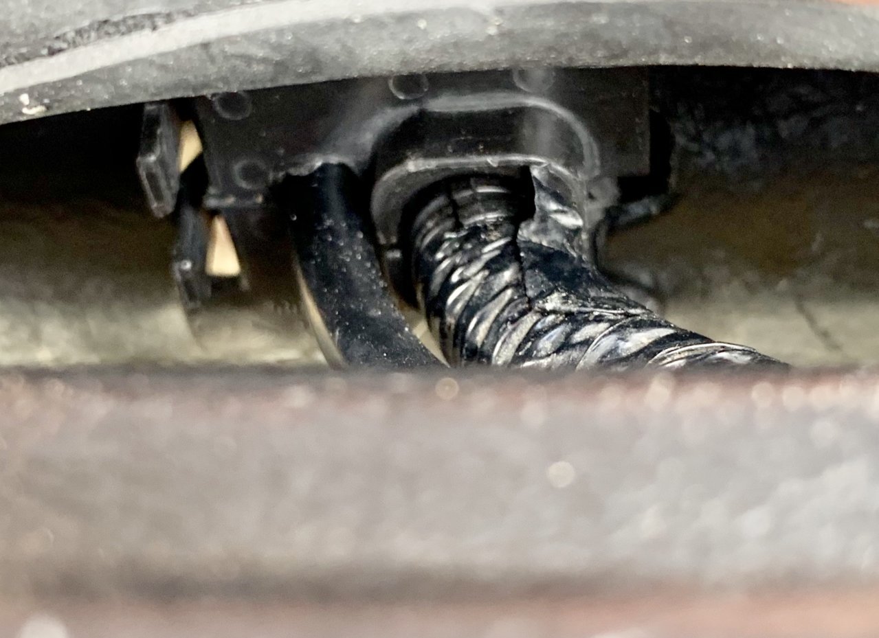

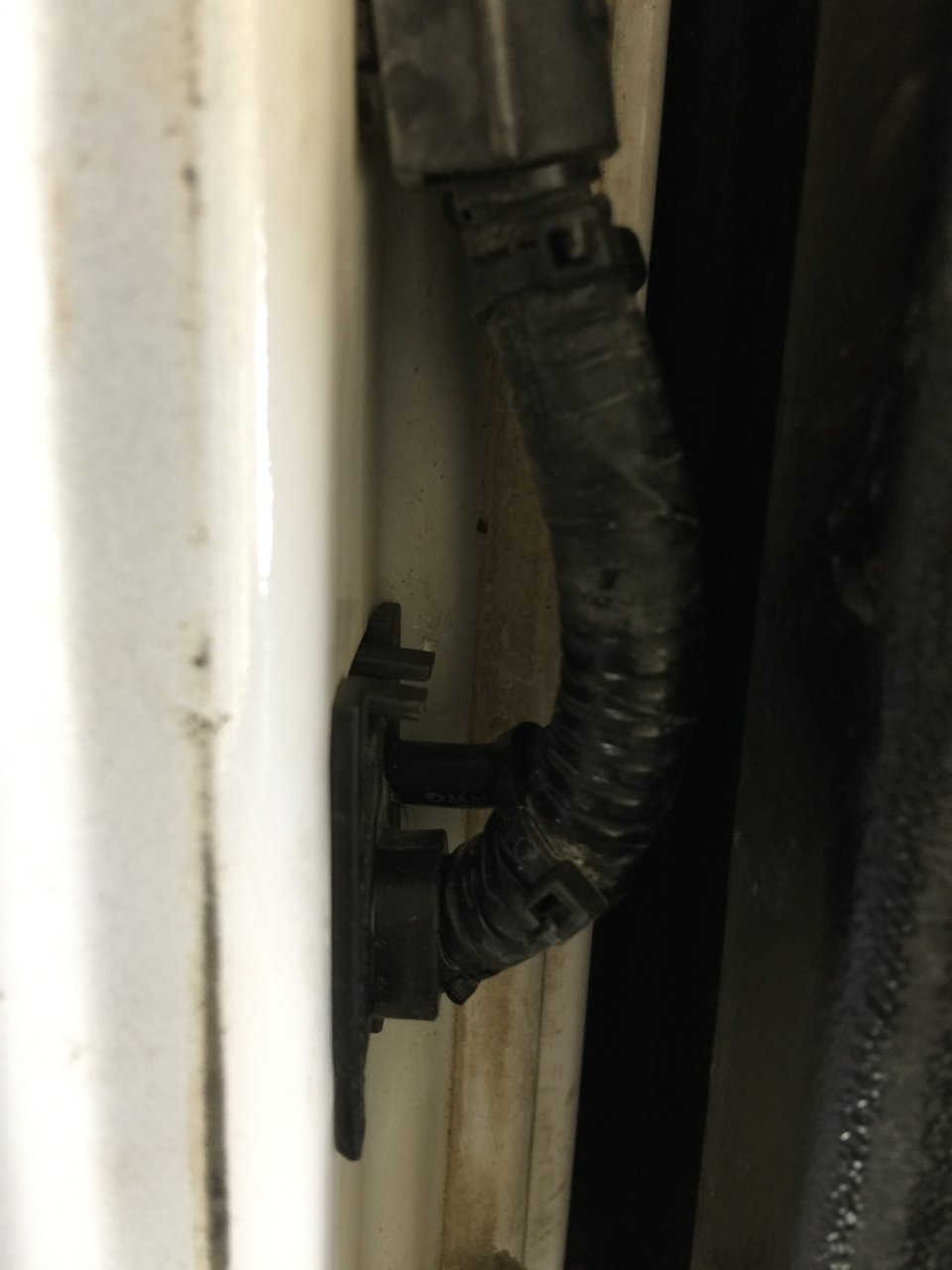

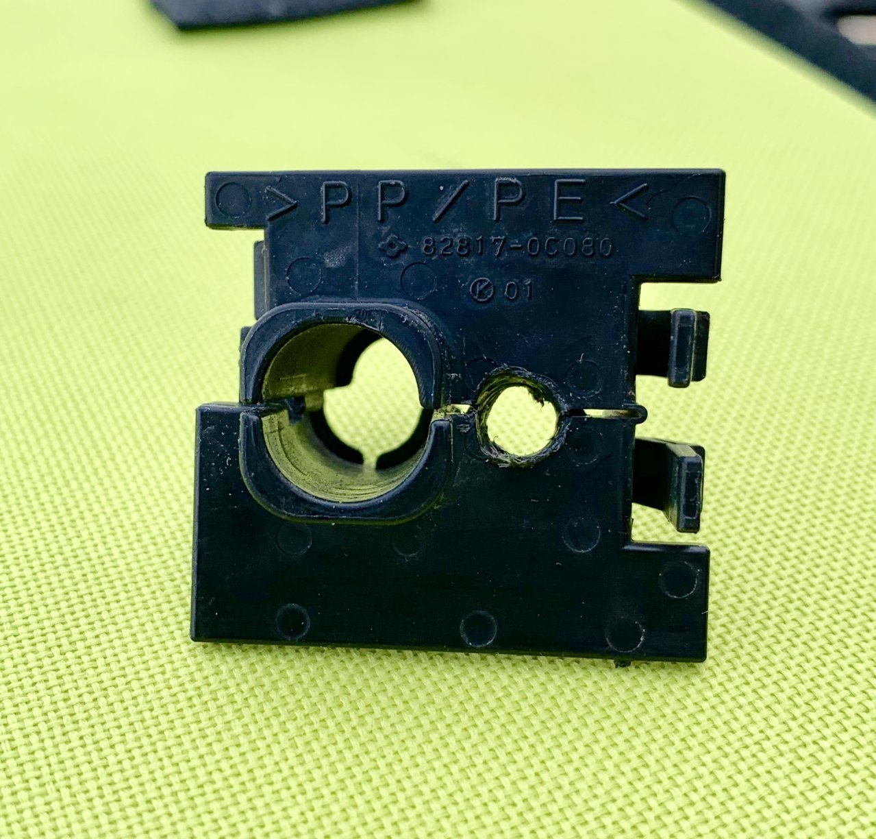

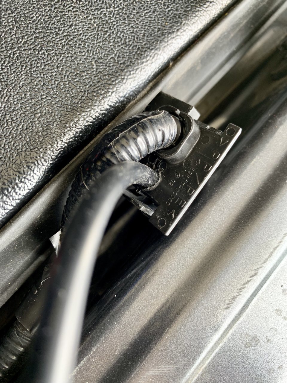

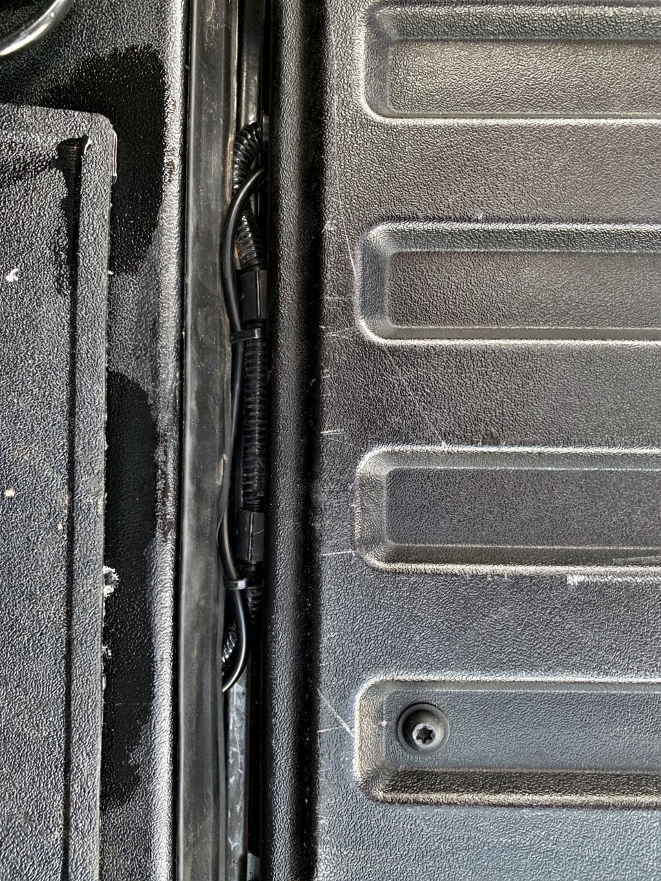

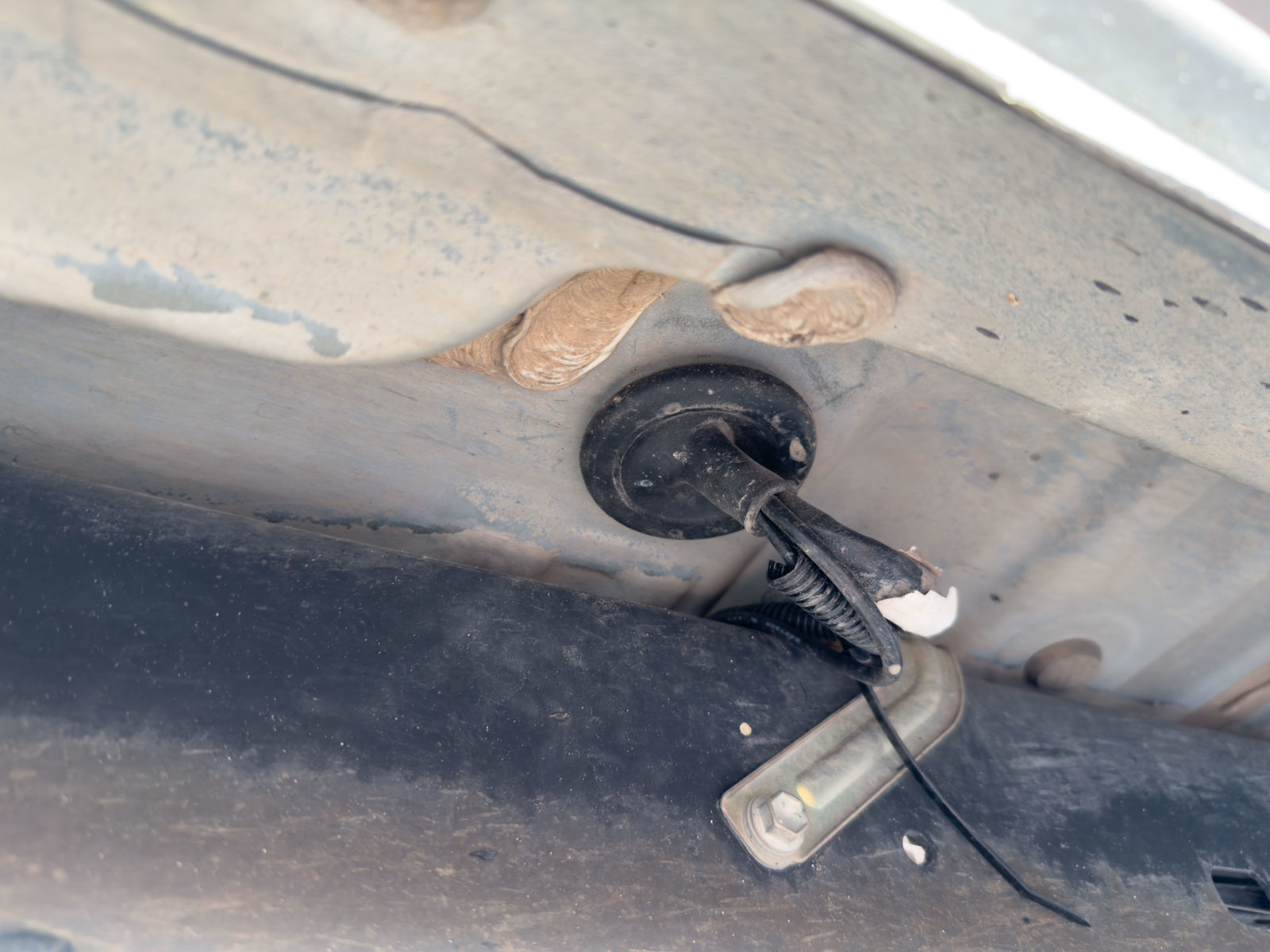

    There's a lot of good information on this thread, thanks to all who contributed, it made my install much easier. I want to share what I did with the wiring where it leaves the tailgate and enters under the truck bed. I used the plastic plugs that the backup camera wires run through by drilling a hole in it for the Pop & Lock wiring. Doing this protects the wiring from rubbing on metal. Also, where the wiring goes through the grommet under the cab, I poked a little hole in it with a nail, close to where factory wires run through the grommet. You want this as tight as possible and the rubber expands easily allowing wires to be pulled through, there's no reason to cut or make a big hole in the grommet.

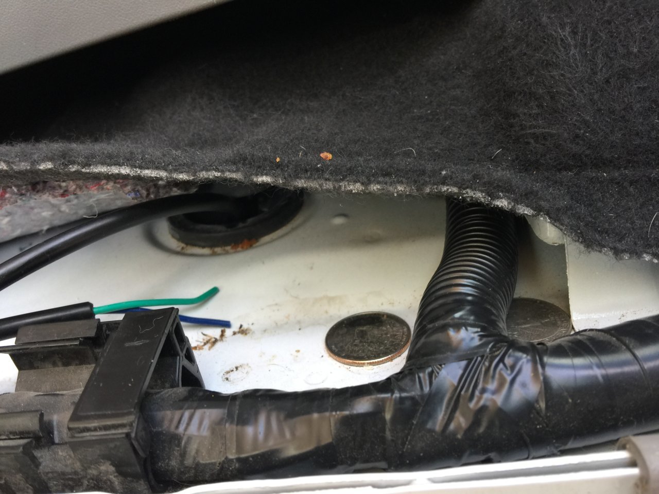

    Installed Pop & Lock today. Followed the back up camera wiring like Gerard6778 post#507, and then through the grommet under the passenger seat. Found some money there lol. In addition to the hose clamp, this definitely adds another layer of security.

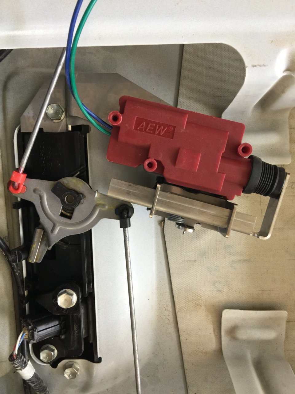

    When locking or unlocking, the bracket will really only move about a quarter of what it should (even after greasing today and previously a few months ago). Actuator also sounds weak and will stop even attempting to budge after a few unlocks and locks.

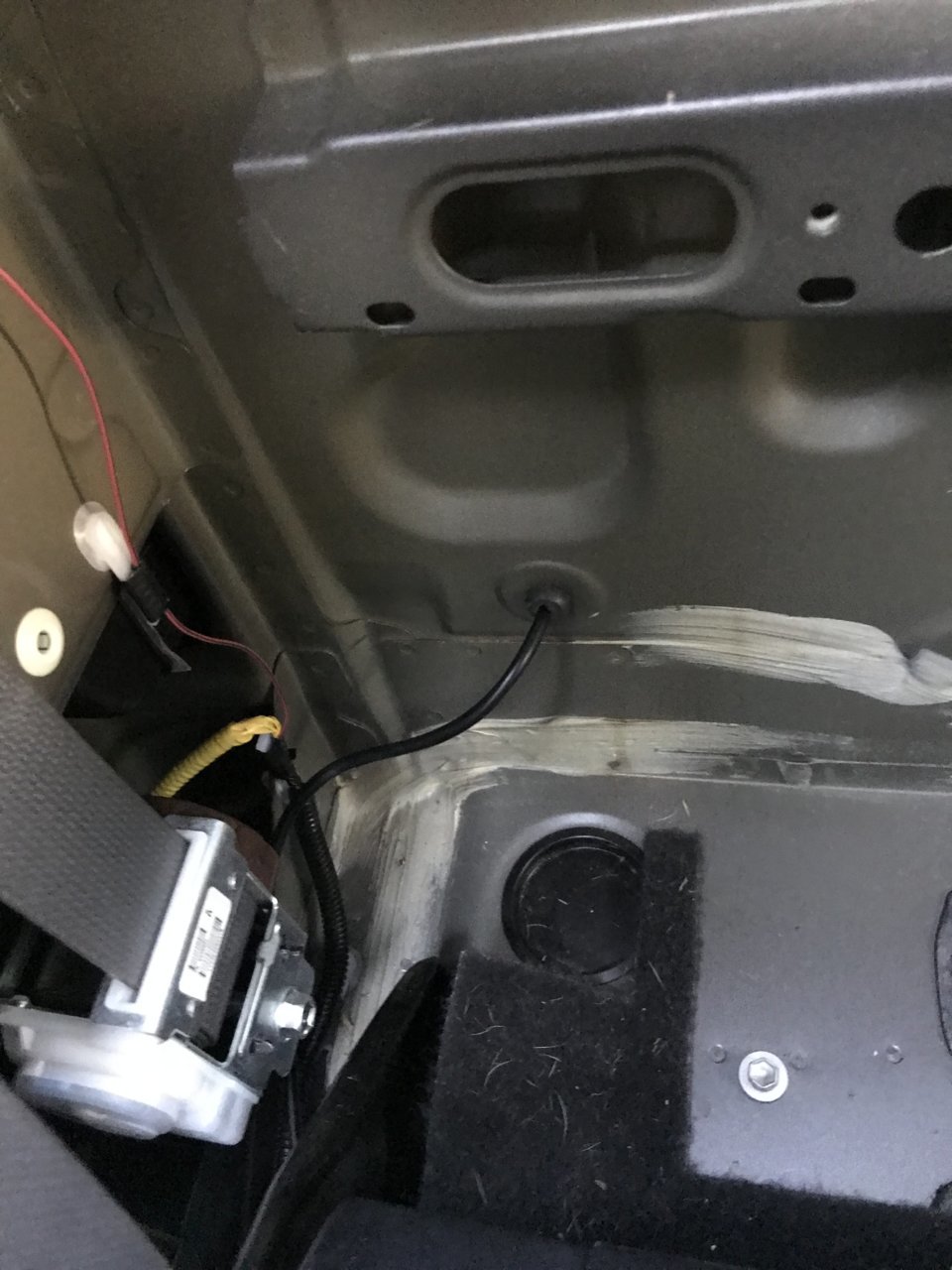

    Used someones suggestion and removed and drilled the plastic grommet that the rear camera goes through in the bottom of the tail gate and through the bottom part of the box. Didn't put it in the loom just under neath it and zip tie in place. Then I ran the wiring down the passenger side of the frame, found a plug in the floor right over the frame about where the rear seat bolts to (same as shown below). Pulled the plug drilled it and ran the wire through for a tight water proof seal.

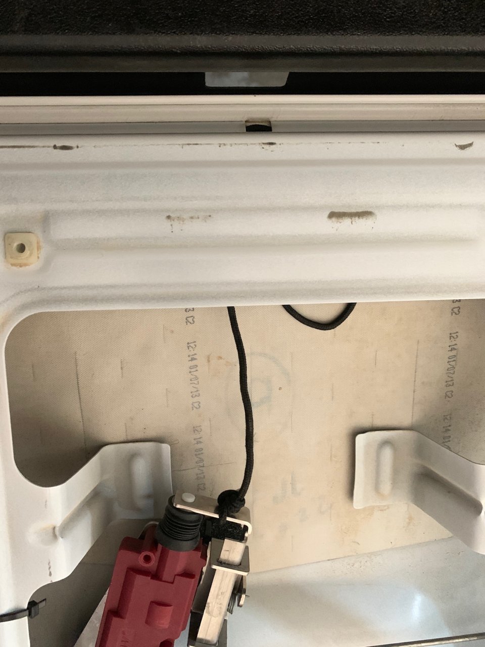

    Installed a safety pull cord in case of being stuck in the locked position. Others have done this but didn’t feel comfortable with the cord hanging out... so instead I taped the cord just inside the hole - you’d have to know it’s there and use a little hook to get it.

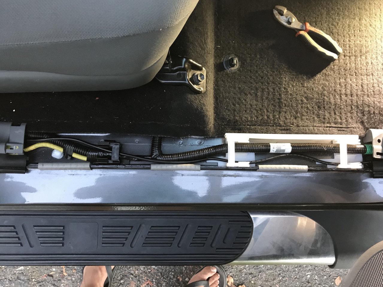

    I used a variation on this method and it worked quite well. My strategy was to run the wiring along the driver's side frame rail, through the factory grommet under the driver's seat, under the door sill, and then through the dash to the passenger side door wiring. That allowed me to avoid waterproofing issues. There are so many posts that suggest poking a hole through grommets and then using silicone. On the factory grommet, simply remove the tape on the neck, lubricate your wires with alcohol, and thread them trough. It's very easy. Re-tape when you are done and you will again have a factory seal.

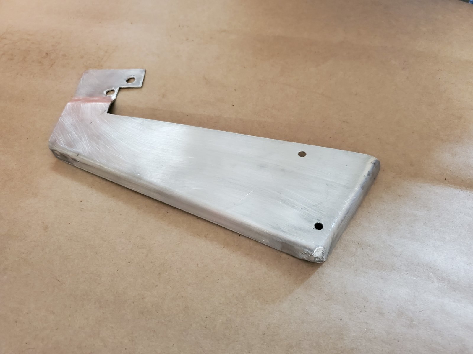

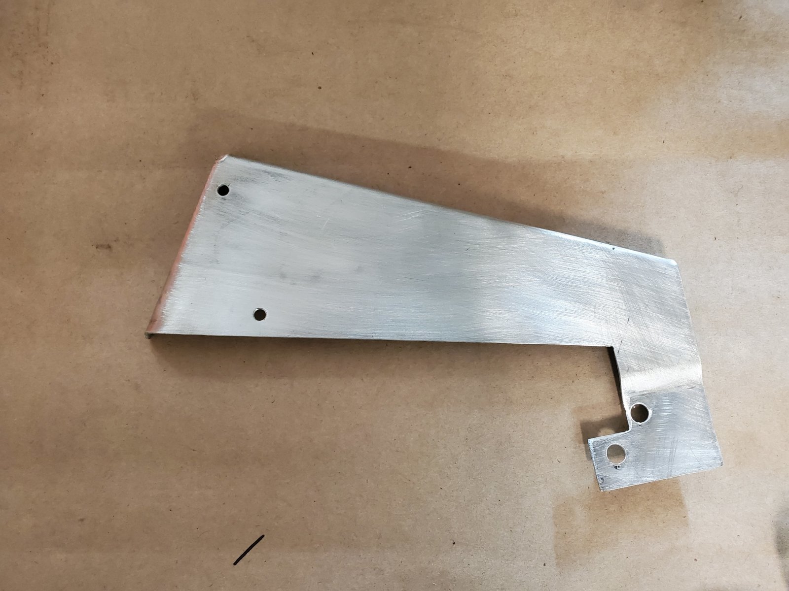

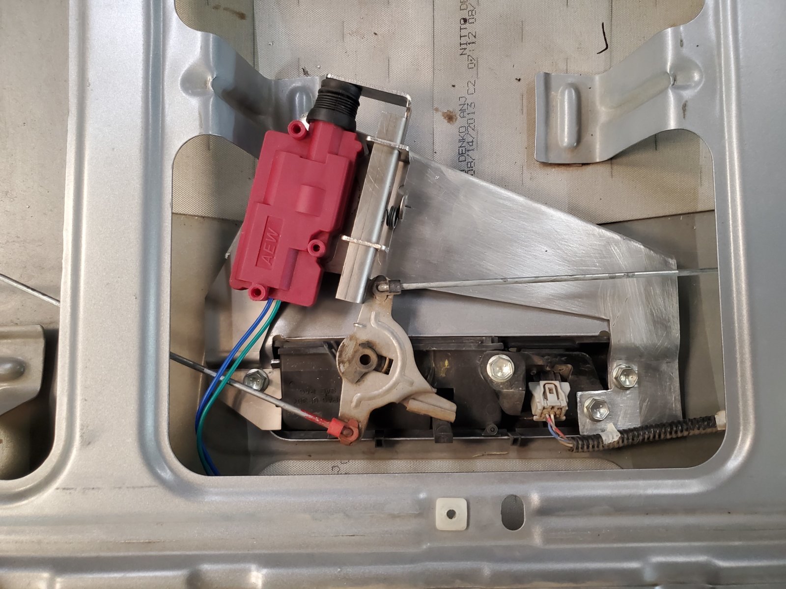

    I made a bracket from the links here:

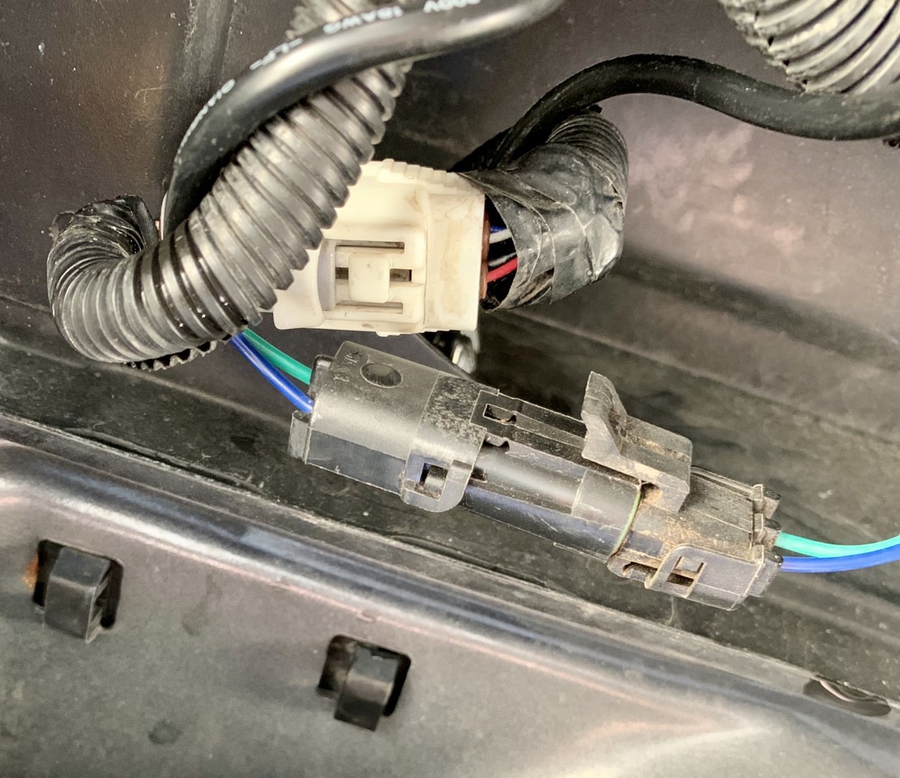

    And wanted to note that the pins on the connector for the blue wires are easy enough to de-pin, soldier and run heat shrink over if that's more up your alley than t-taps:
    Thanks again!
