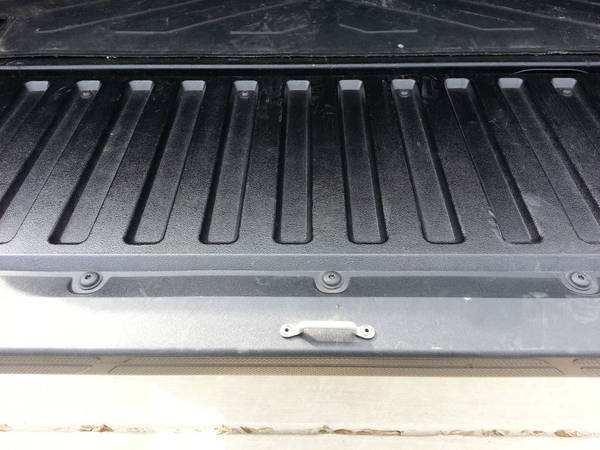

    You can see in this picture, the loop for the locking mechanism for the G4 is riveted to the upper portion of the plastic cover on the tailgate. Do you need to remove the upper portion to install the lock?

    ^^ No, you only need to remove the large plastic panel below that upper portion. Once you get that panel off, you'll see the tailgate handle where the lock is installed. From there, just follow the instructions in this thread.

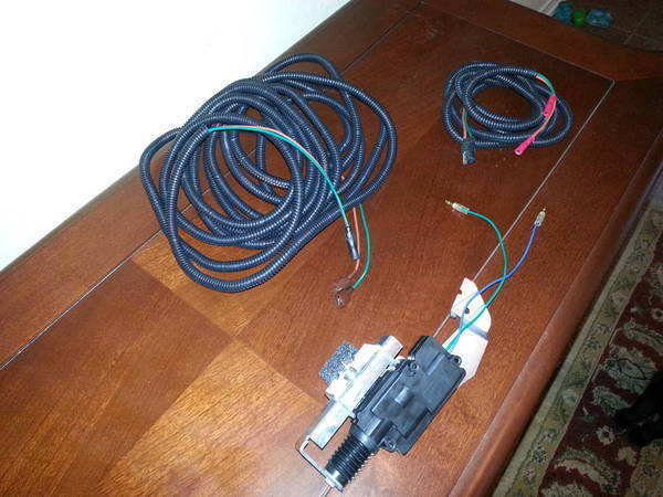

    Got mine in the mail, my wires are a different color than yours. Has me slightly concerned, looked like a returned item the way the packaging was. Does this look right?

    I think mine were that color. I don't think it matters which wires plug in where as long as the polarities are the same (ie it locks when it's supposed to lock). If it unlocks when it's supposed to lock just switch the plugs on the solenoid side of the wire and then crimp.

    You are good to go. That's what mine looked like!

    Cool, thanks! Gonna install it tomorrow after work. I plan on shortening the wires instead of having a ton of extra wire wadded up in my tailgate. Also, mine seems to have come with a "sponge" unless that's just for packing. Maybe they updated that in the last couple months?

    That sponge may be to put between the solenoid and the back of the tailgate? If there's nothing there it will rattle when the gate is shut. Nice they include that now.

    Mine came with the sponge as well. It was a perfect fit, just snug enough, for between the solenoid and tailgate. So I assumed that's what it was for and left it there. I don't here any rattle when shutting the tailgate. Although the actuator is loud when locking and unlocking as others have stated, but it doesn't bother me.
