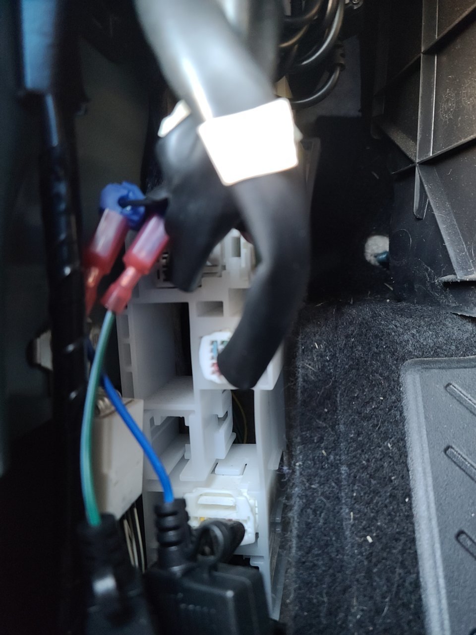

    I am installing the unit on my 2019 Tacoma and am puzzled by the instructions which say splice the two wires into the black and blue wires on the “IC1” 10-pin white connector on the driver’s side. Don’t see any connector markings or indicators so I am not certain which one I should be fooling with. Some have more pin slots and less wires so I can’t say what I am looking for. Anyone have any idea which one I am to be using?

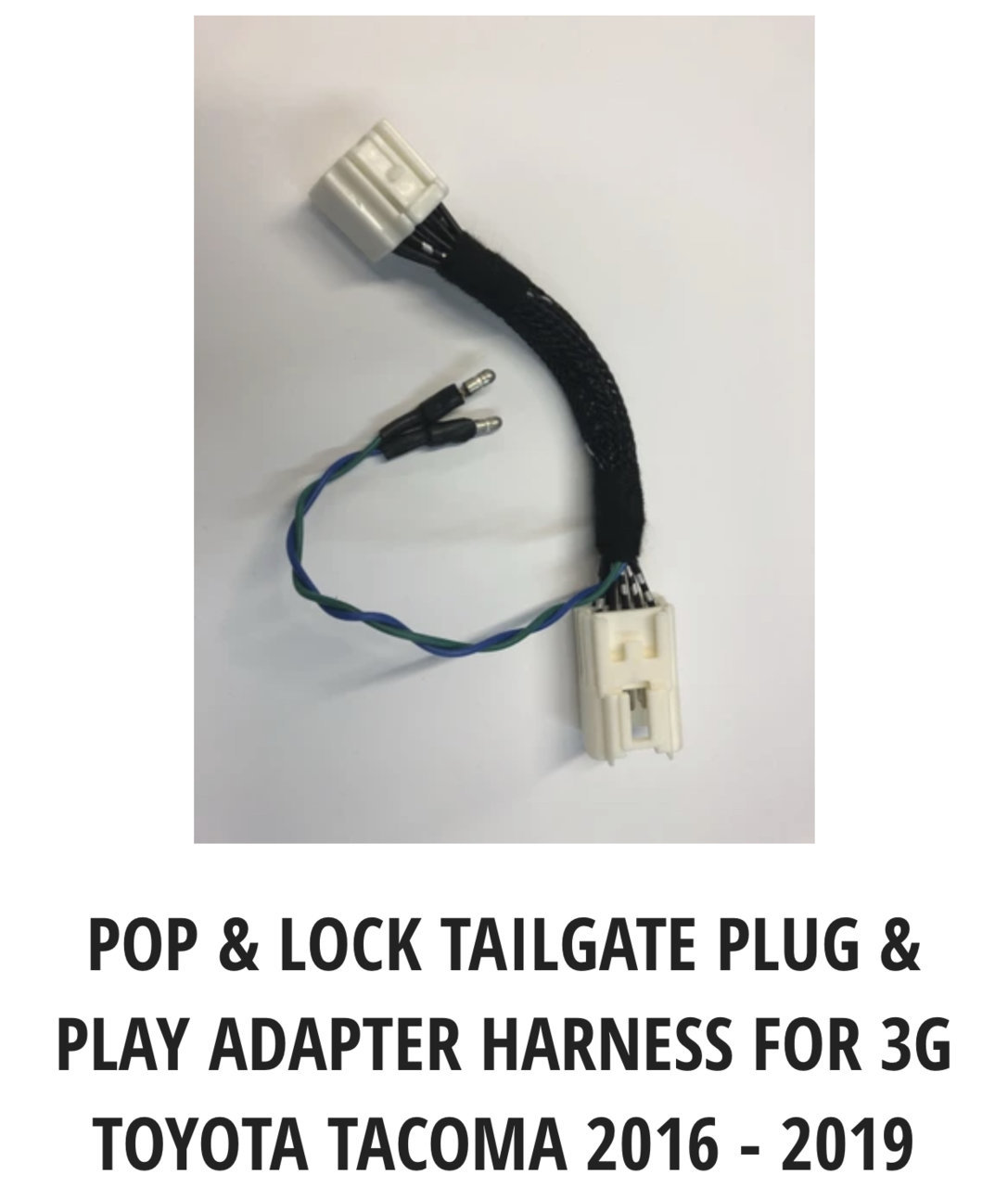

    ktjo4x4.com sells a plug-n-play kit so you want have to worry about splicing the wires.

    Saw that plug, but since it was light grey, I wasn’t certain. Thanks for the picture.

    Well, I hooked up the wires to the drivers side as instructed but when I hit the lock function in the remote, the doors all lock but the tailgate goes to the unlock position. When I hit the unlock function on the remote, the doors unlock normally but the tailgate does nothing.

    I got the OEM kit and it comes with a harness where you daisy chain the connectors. No splicing needed and it was easy to install myself.

    Finally got it working. Used the passenger side instructions instead of the drivers side and all appears well.
    Thanks everyone for the responses.
