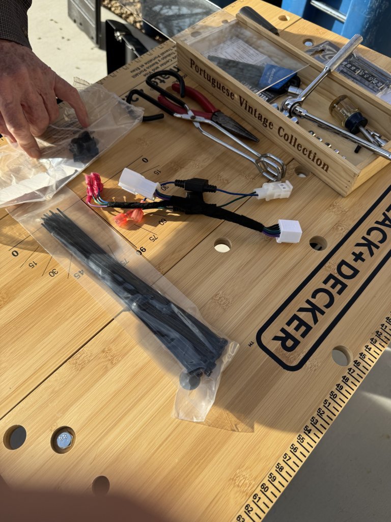

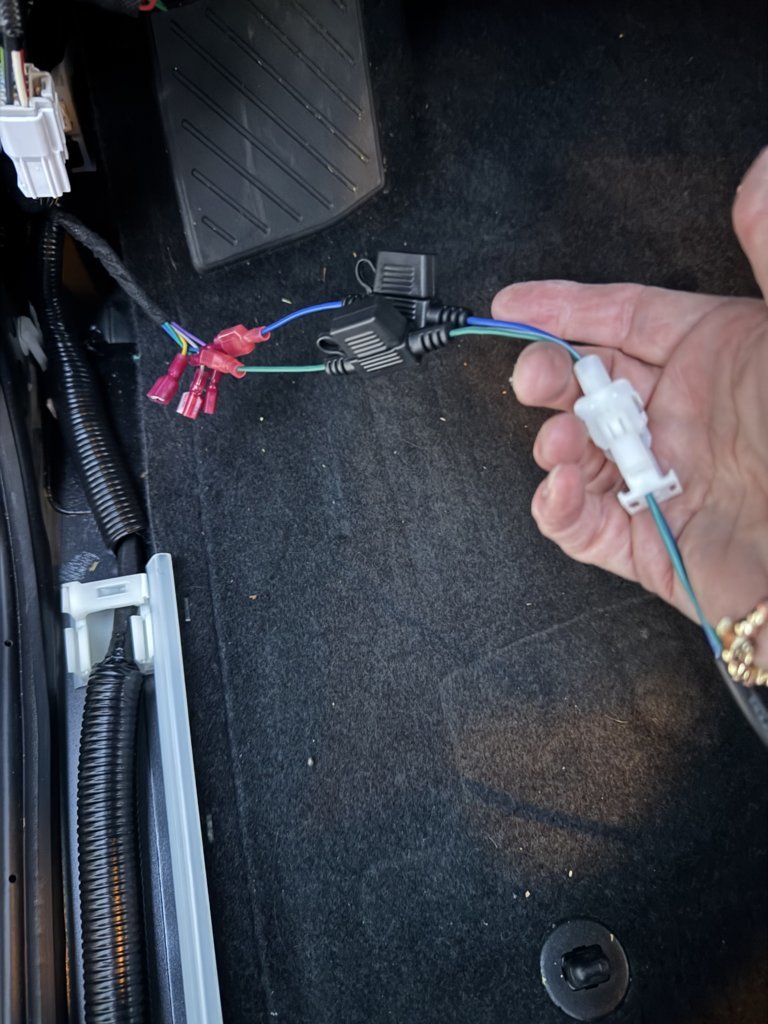

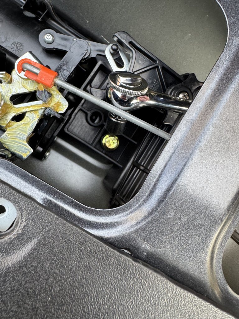

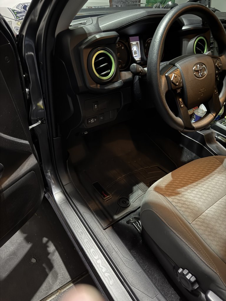

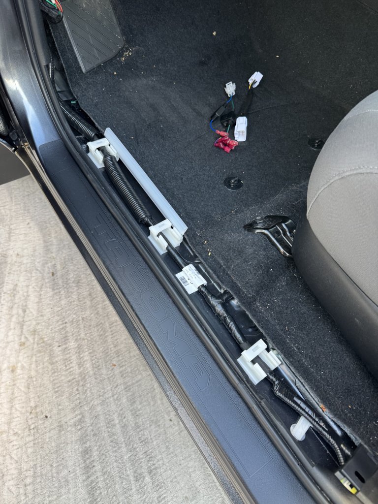

    IMG_5436.jpg IMG_5430.jpg IMG_5431.jpg IMG_5428.jpg IMG_5437.jpg Yesterday I added this lock to my tailgate. All plug and play and works like a champ. Watched Chloe on YouTube first because I have never done this sort of thing and was a simple job. About an hour. Bought at Amazon. 23 SR.

    I wanted to add: the grommet that you remove under the seat to run the wire up into the cab of the truck would not actually install properly after you put the wire through. For obvious reasons. I took a leather punch and found the size of the cord that was running through for the wires and I just punched a hole in the middle of the Gromit. It fit nice and snug. Not perfect, but still seals that grommet hole up very nicely.
