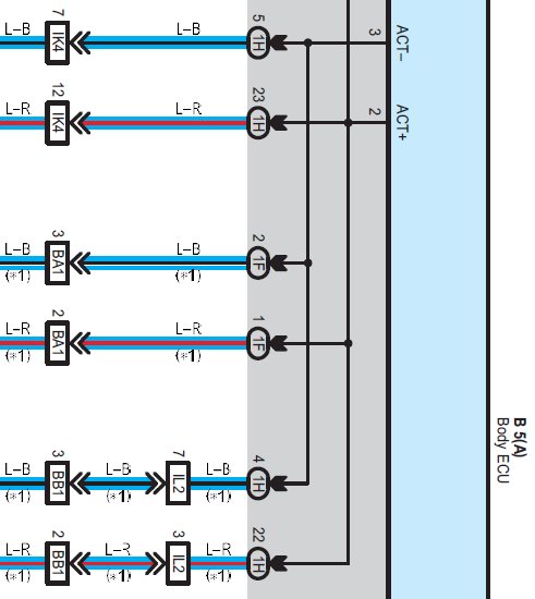

    Hi everyone,
    I just got a 2013 2.7 access cab. I'm trying to install the pop and lock wiring under the driver's door sill but can't find any of the correct colors. I even tried a few different wires, but they didn't work. Does anyone know the correct wires for lock/unlock? The wire bundle is 82162 04210.
    Thanks in advance

    Thank you so much! I actually just got it figured out. I had to follow the harness into the door to find the correct red/blue wire. Apparently it's not in the same harness as the black/blue wire. Took forever, but glad I got it working. Thanks for your help
