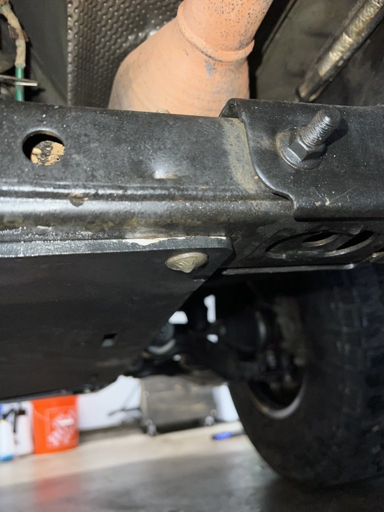

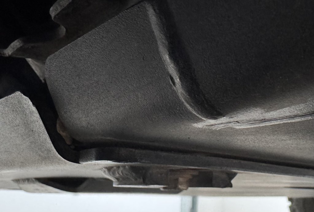

    Figured this might save someone else some headache. I'm sure this isn't related to just RCI or aluminum skid plates, but I kept having this very odd like "pop" noise coming from the middle/front of the truck whenever I'd enter my driveway and or body would flex when driving off-road, etc. I can't tell you how many times I checked torque on my LCAs, ball joints, UCA, wheel lugs, etc. I've got a lot of aftermarket stuff but I am a nut for making sure I'm following torque specs on suspension components.
    I've got the RCI engine and transmission skid plates, and when you go to install these, you remove 4 total frame/chassis braces. Two near the catalytic converters, and two from the front subframe to the bottom of the radiator mount. Knowing this, I started looking for hints that these were causing issues. Basically my poor scientific mind equates this to, the skids staying "in place" as the frame flexes, but then skips (very slightly) when the bolts are not tight enough on the skids since they're essentially functioning as frame braces now. See attached photo from the back of the transmission skid that led me down this rabbit hole, chipped powder coat from what I assume was it rubbing on the crossmember on frame flex. It's not corrosion on either the crossmember or the skid, that's all mud in the photos. Retightened all my skids, specifically these last two bolts on the rear of the transmission skid and all is tight and quiet! RCI doesn't list torque figures on any of these bolts, but these last two on the transmission skid were pretty darn tight, now they're hulk tight and staying quiet.

    I also had the clunk and after trying everything it was my rci skid plates. Put some delrin or fender washers in between the plates. They are rubbing on each other and popping. You can see the powder coat rubbed away.
