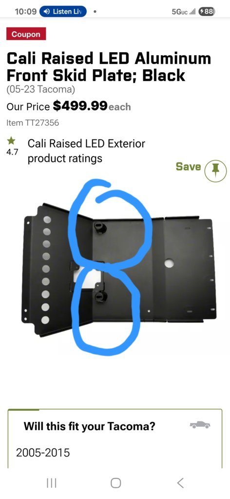

    Update on the skid noise problem. The upward bracing posts of my RCI engine skid were scraping the frame front where they abut. So I placed some wide, thin rubber washers on top of the posts, used my floor jack to lift the plate into place, thereby holding the washers atop thScreenshot_20250521_100912_DuckDuckGo.jpg e posts, then tightened down with thin rubber washers between steel. Photo example below.
