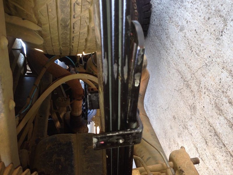

    Show us a pic of these fancy new 4 leaf pacs, I'd like to see the thickness of the overload and the possible second overload.

    As requested

    Ooh, those are curious.... 3 leafs and an overload. I think those will definitely last longer and probably have a bit more capacity. I wish Toyota would take a few pointers from OME and use more than one overload to progressively save our springs from negative arch. My new leaf pack has 2 overloads that bend and a 3rd that doesn't (the end all be all leaf). Please keep us updated as to how they handle and whether or not they flex more. :)
