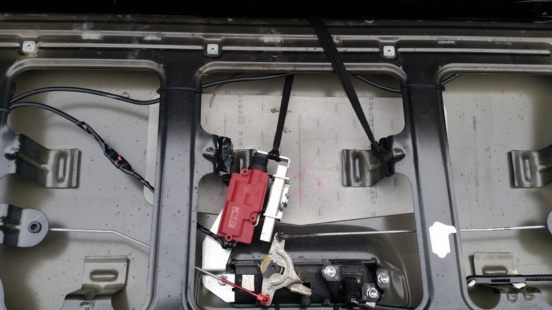

    For what it's worth.....
    The picture below shows the little bundle of wires behind my passenger side kick panel.
    I spliced and connected in the cab as follows.
    Blue / Red (truck harness) to Green (Pop n' Lock)
    Blue / Black (truck harness) to Blue (Pop n' Lock)
    This opens the tailgate mechanism with two clicks of the unlock button on the fob along with the passenger door and locks Pop n' Lock and both doors with one click of the lock button.
    Pop n' Lock does not actuate on one click of the unlock button when drivers door opens.20161029_113102.jpg
