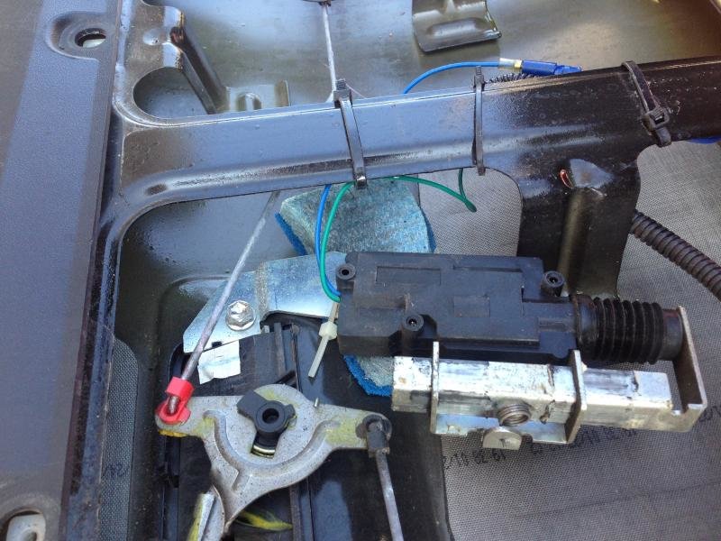

    i have the electric version of the pop&lock tailgate lock and ever since i installed it i had an annoying BUZZZZZ every time i shut my gate. i tried the sponge trick and it didnt work. So i came across this product.

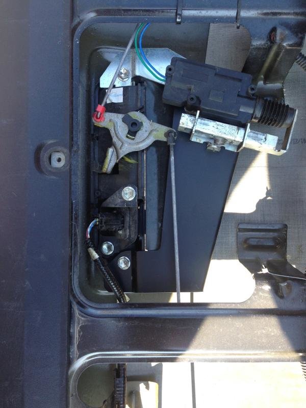

    http://tacomatruckparts.com/product_pl8521_bracket.htm
    installed it and the BUZZZZ every time i shut my gate is now gone!!
    old fix that didnt work
    12ED6B6B-1948-4E22-9F0D-DF5FB8A8AF00_zps_bb1b1311b935fd0f7d28bb721d59d3073ea065db.jpg
    new fix that does work
    0FBECCBD-498D-4B27-B372-5FB205AA7DD2_zps_3711f2e8fab3c5329324774d605ba521aa33dea1.jpg
