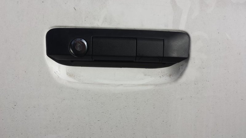

    And done. Yes... truck is dirty, I'm waiting for rain, and remember, this replaced the old style lock for '05-'09 that used the factory handle but added the black piece below it. Looks like I might have a small score mark in the paint but it's not obvious.
    So did anyone else have to remove the screw in the middle to lift and rotate the plate? The end of the plate with the red catch on it would not no way no how clear the edge of my opening.

    You mean like it literally won't turn? Cause I know it only turn maybe less than a quarter to either lock or unlock.
    I ended up putting some powdered graphite lubricant inside the bolt just to make the key go in and out easily. Works pretty good.

    Yep, won't turn at all. When it was working I experienced just as you've noted it only moved a 1/4 turn right or left...but now nothing. I took the back panel off the tailgate and had a look. The mechanism to "lock" the handle can be moved manually so it's not hanging up on anything. I used some of the graphite as well (works like a charm on my motorcycle ignition), so the key isn't having any issues going into the lock, I just can't turn it.
