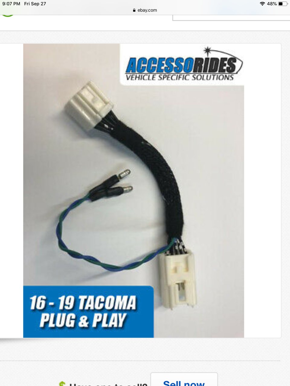

    Any pics? If given the choice, I’d prefer to use factory hardware

    Kymann
    Kymann Well-Known Member
    Jul 8, 2018
    #258671
    206
    South Central Ky
    2016 TRD Sport with tech package...
    A8D9705A-7ECF-4496-BBC2-2B08E82991AC.jpgThis is what I used...A8D9705A-7ECF-4496-BBC2-2B08E82991AC.jpg
  19. Sep 27, 2019 at 7:12 PM
    #19
    Rainoffire
    Rainoffire Well-Known Member
    May 31, 2018
    #255034
    3,104
    2017 QS DCLB TRD Sport
    That looks exactly like @KTJO 4x4 's harness...
  20. Sep 27, 2019 at 7:15 PM
    #20
    Kymann
    Jul 8, 2018
    #258671
    206
    South Central Ky
    I got it off eBay before I saw hers, probably paid more but it worked perfectly...I was very satisfied...
