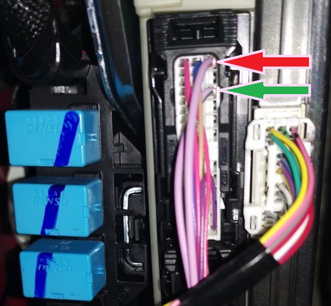

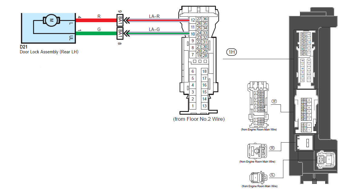

    If it does not use the trigger for Lock and unlock.... then which wires would it use? I see the BA1 connector in a prior post, and that lives in the B-pillar. Is there an IC connector that feeds the BA1? If so, would it not have the wires that are the BA1 8/9 (red/green) that would be the right ones??

    Which unlock/lock source do you require? Driver's or everything else after Driver's is unlocked?

    I am hoping for everything after driver's door so I can use the double tap on the fob for unlock and not have the tailgate lock/unlock every time I get in the truck.
