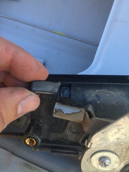

    This thread saved me. That ishty piece of plastic they call a handle finally broke mid pull. Luckily my key still unlocked even though that felt like it was going.
    You would think that they could look at an existing spec before skimping on the design.
