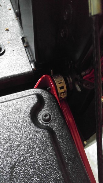

    Or you could do the hose clamp mod in 5 mins for $5.
