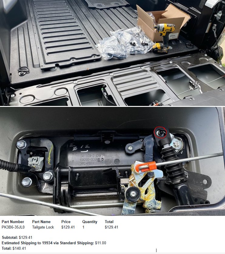

    TacoTime55
    TacoTime55 TT58
    Sep 28, 2021
    #378314
    9,516
    Ed
    Delaware
    2021 Midnight Black TRD Sport AT/DCSB
    TRD Lift,OTT Tune, LED HLs,TRDSkid, TalonCAT
    Here's the OEM box mine came with...I did not do a close-up but the P/N I ordered is listed below.
    I did need to install the locking press nut (I did), which I circled in photo.
    It does say it's for a Long Bed when I did quick search but I do remember there are 2 P/Ns base on bed size.
    Post# 12 starts off the install: https://www.tacomaworld.com/threads/trd-sport-5-14-2021-loving-my-3rd-gen-tacoma.738836/
