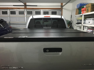

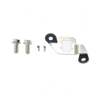

    Where the wires were crimped under the kick panel would be my guess if no other routing issue under truck. That was my sore point when I installed mine. Bad angle to get a good, clean crimp. Got them crimped but if not pressed just right I'm sure could give a false or short term connection.
    Did the pop and lock first then installed my G4...lot of work but the end result is awesome! Would highly recommend getting the metal camera mount kit. The oem plastic one is easy to crack and mine did with light pressure. Superglue kept it together until the metal one arrived. Quick to replace and life is good again!

    Metal camera mount kit?

    My bad...camera mounting clip...
