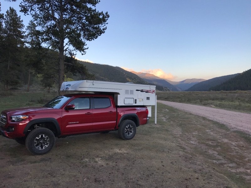

    I did airbags and new Leaf springs. Leaf springs give me the lift when it is not on there but was not enough for the camper, so airbags do the trick with that. Ride quality is not as good as factory but it is not the worst and kind of like the rough ride. Truck does really really well when the camper is on it.
