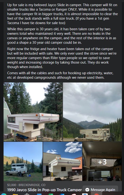

    I just found this camper local and going to go look at it. I have a 2nd gen 4door short bed. what does TW think. will this work. any thoughts the collective TW has. things to look for avoid just asking for advice as i have never owned a camper before. thanks

    It looks like its for a 6' bed..

    For $3K that's not too bad. You'd play hell trying to find a FWC for that price. There's a lot of info on truck campers on WandertheWest.com as well.

    yep that's part of my question any concerns on it being on a short bed or somebody who has done this and if it will work and how well

    Full disclaimer- I have no experience with these. Anyways the biggest problem I see is how much weight is going to be hanging off the back of your truck, or more importantly behind your rear axle. Maybe a set of airbags could help with the boncy rear end, but i imagine its going to turn weird either way.

    You should locate the camper's center of gravity over the axle. The owner's manual has specific guidelines to the location.

    As nicely priced as that is, I wouldnt want to put a 7 foot camper in a 5.5 foot bed. Not without knowing exactly where the COG of that camper is.
