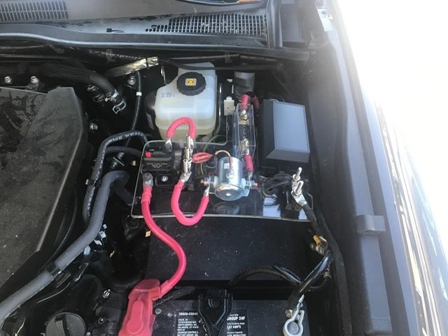

    So I have a weird issue I can’t seem to isolate and am looking for ideas.
    I made an aux fuse panel, powering a set of lights and an Aux power supply to my dump trailer.
    Pic shows how it’s set up more or less.
    I have a Continous duty solenoid that’s delivering power through 4ga wire to the rear of my truck to help charge my dump trailer. This solenoid is activated via a switch (Air on Board switch). The trigger wire is activating a relay, which in turn activates the solenoid. Both the power supply to the relay and the trigger wire are fused.
    Inside the cab, the ignition controlled power supply to the switches is fused as well, stealing power with one of those add a circuit gadgets.
    I am popping the add a circuit fuse to the switches. It had been a 7.5a fuse. It’s powering 3 switches. I’ve since put a 15a fuse in as that’s all I had and I needed a switch on (2Lo switch) to finish where I was going.
    I’m trying to figure out why I keep blowing that fuse.
    As a side note, I previously ran the switch directly to the solenoid. It worked fine for about a year. The the switch was burned out. Then the second switch burned out. So I added the relay in between now am blowing the ignition controlled fuse.
    The trailer will draw 40amps. (Resettable 40a CB on trailer end that cycles off and on while dumping with high current draw)
    Could the solenoid be somehow backfeeding weird causing the switch or that fuse to blow? Even shutting the switch off before the high power draw does not save the fuse.
    I’ve searched for a chaffed wire to no avail. Replacing the solenoid is next but I hate throwing parts at it for no reason.....
    Thanks for any insight.

    Thanks for the suggestions so far. Got the truck in the shop today so can better look at things. I spent more time trying to find a way to draw something neat and more understandable than hand drawing, than it would have to have hand drawn the schematic. As it worked fine for a year, I’d think it’s all ok. And the new issue is intermittent so I’m guessing I have a pinched wire someplace. I have wires routed around underneath the dash and they come in near the clutch pedal, last night at quick glance I saw the clutch pedal spring has been moving my rats nest if a wire bundle around so a better tidying job if that is in order. It’s likely chaffed somewhere up there and I just haven’t looked good enough so that’s step one today. I believe my multi meter will show me Amp draw (years ago I may have blown the multi meter fuse for ammeter and couldn’t find a replacement weird size fuse) but I’ll give it a go today as well. I Just can’t see the relays taking very much current to close....
    Flurries are in the air so it’ll be a good day to have the fire going inside and tinker....
  10. Oct 18, 2020 at 2:30 PM
    Thunder chicken
    Thunder chicken [OP] Well-Known Member
    May 31, 2018
    #255035
    114
    NW Ontario
    ‘18 access cab manual
    So.... put multi meter on the add-a-fuse line and had less than 1 amp draw with 2/5 switches powered. Also hooked up dump trailer and checked it with the solenoid powered and all was the same as it should be.
    I found my solenoid trigger wire chaffed in 3 spots from the poor routing and the clutch spring catching it. This caused the failed switches.
    I could not find a reason for the ‘add-a- fuse’ fuse to be blowing. Well, there was one crimped connection (On the +12v add-a-fuse line) that I had to make (rather than soldered) and it was loose-ish but not falling out, maybe that poor connection caused it.
    All wiring cleaned up, loomed and tied up the way it should have been. I had done the install in the cold outside and never ‘finished’ it apparently!
