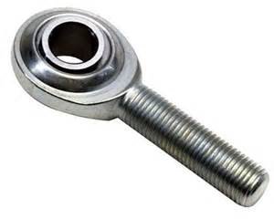

    Maybe a bad rod end?
    Jack up the front passenger side and shake the wheel from side to side to see if you have any play or if you hear any noise. If you do I would replace the rod ends on both sides and get an alignment at the same time.
    Some places will give you a free alignment check and might spot a worn or bad part during the check, especially if you indicate there might be worn parts. Most shops will be happy to replace them for you...for a charge of course.:rolleyes:

    Definitely sounds like a bad rod end. I had a Dodge Dakota years ago that exhibited the same symptoms.
