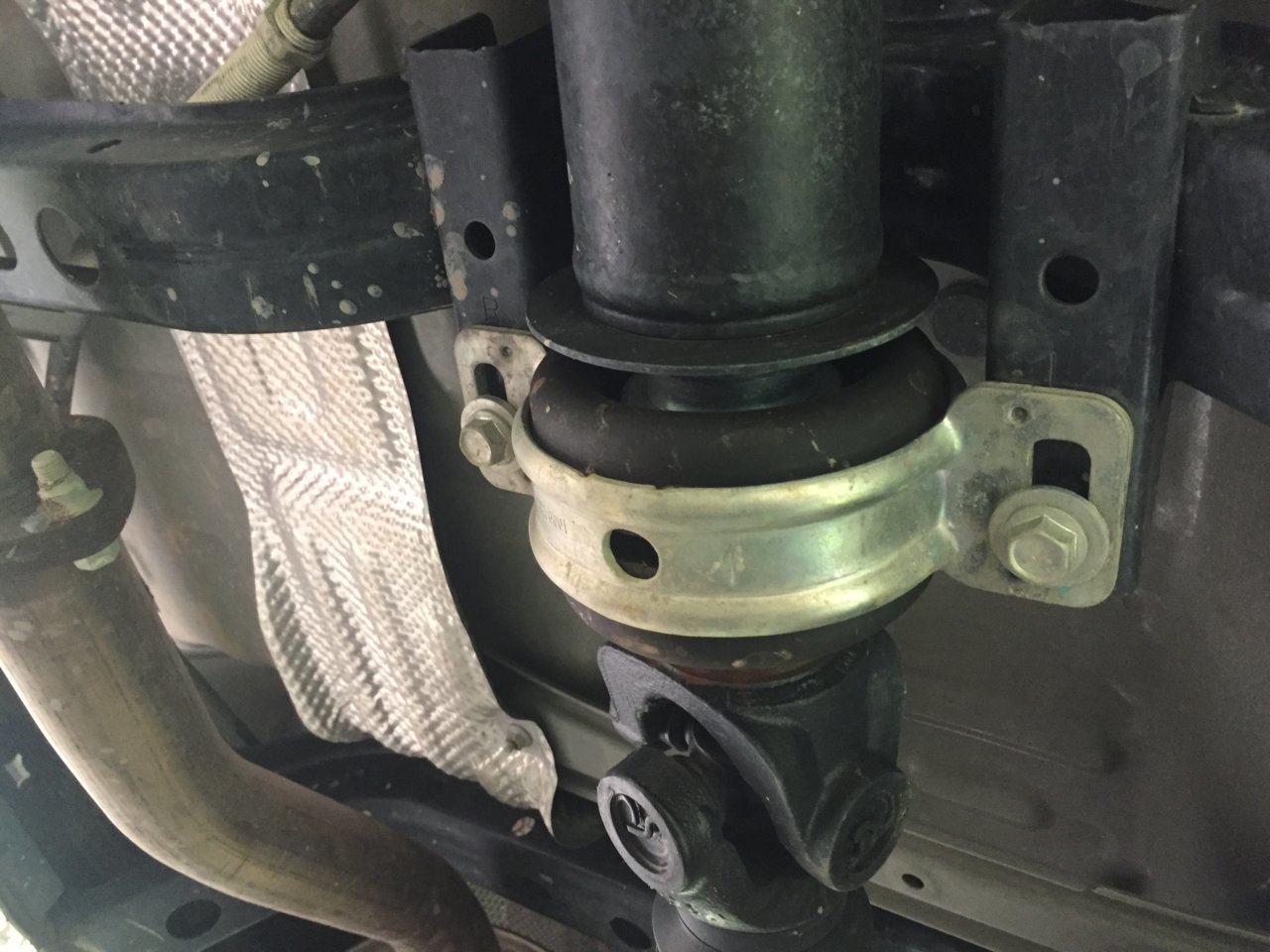

    I'd be looking at the carrier bearing. Sure looks like it makes the sound every time the axle goes up and down. Also could be axle at carrier bearing too not sliding smoothly. The axle is supposed to move in and out smoothly. When it doesn't it's axle wrap is what it called. Feels like a basket ball rolling in the truck bed if its bad enough. Yours sounds like something in the drive line is loose.
    Carrier bearing mounts have been found loose from factory as are U-joint bolts not torques to spec.
    Quick crawl under the truck and look at carrier bearing mounts should tell you pretty quickly if its that or not. Loose one looks like this:
    And vid to show you how to add spacers should you have a vibration after lifting but shows you where the bolts are to tighten. Pink arrow pointing at the carrier bearing mounting bolts.
    https://www.youtube.com/watch?v=v1SWLDUtDKE

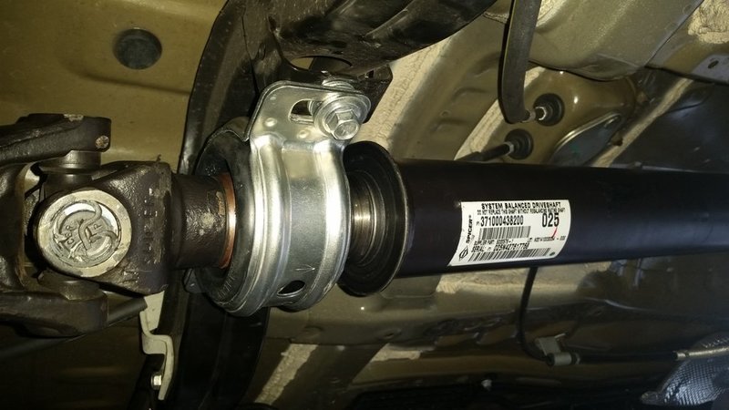

    My carrier bearing
  18. Jun 11, 2018 at 2:46 PM
    #38
    Uscgamecock7
    Uscgamecock7 [OP] Well-Known Member
    May 3, 2017
    #218058
    1,184
    Nick
    West Columbia, SC
    2015 Tacoma Trd Sport DCLB 4x4(SOLD) 2017 Tacoma Trd OR 4x4(SOLD) 2024 T4R TRD PRO
    So tightened her up nice and snug but no luck still making the knockin noise. Should I try the carrier bearing drop before I take it up to toyota?
