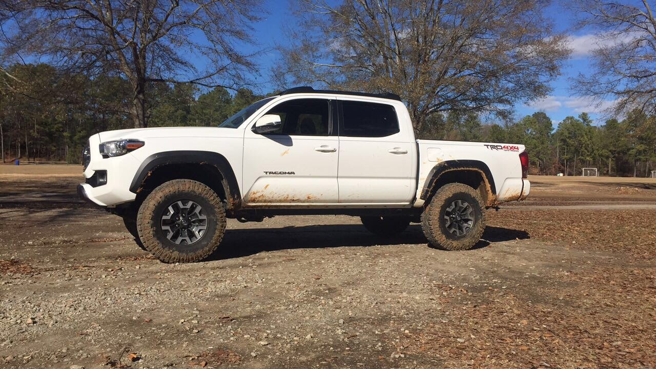

    Alright boys takin it in to toyota wednesday at 8 am and dropping it off. Ill make sure they tell me “what they think is wrong” before I do anything. Anybody wanna lay down bets on what there going to say..... 68141D70-A8C5-4BE4-8420-BB1DB04943FF.jpg
