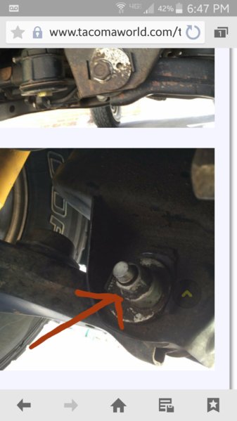

    See how you do after you torque those cam bolts.

    I sure will. Just not sure which ones to put a wrench on. Don't want to change the alignment.

    Wrench down the nuts, only the nut will tighten, you need a different size wrench for the cams.

    Thanks pudge! All the nuts were tight. Torque wrench set at 100 ft/lbs and got the click without moving the nuts. Any other ideas?
