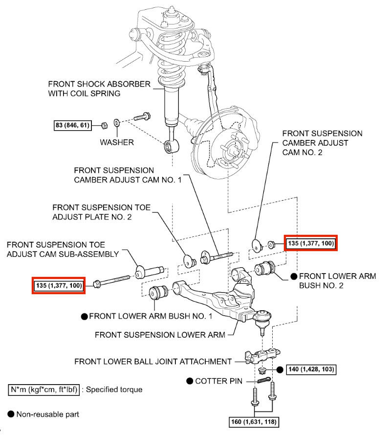

    Try re-torquing your lower control arms to spec, first.
