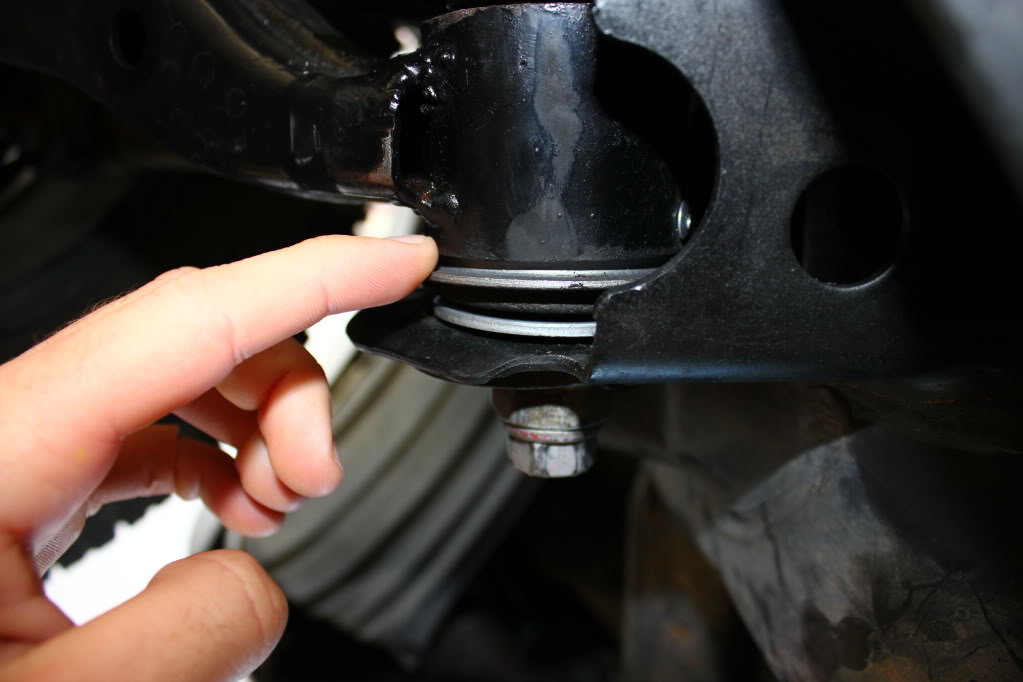

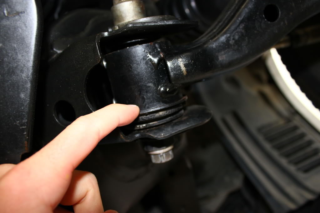

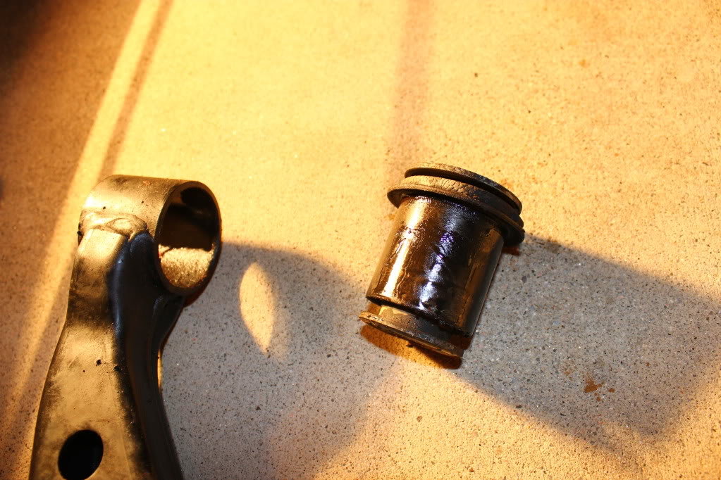

    I've developed this popping sound that occurs in the front end of my truck (2wd, 33" tires, lift spindles, chaos arms). It only occurs when I'm driving along heavily rutted roads which shift the truck side to side (Indiana Jones style driving). I don't hear it driving on asphalt unless I turn into a drive abruptly at speed. It doesn't seem to affect my alignment as the steering wheel never changes alignment after. I'm thinking cab mounts (But I'm 08' & tsb is 05'); Or wheel bearings (but I don't hear/ feel it on the asphalt); or alignment cams (can't see any shiny spots from wear).. WTF??
    How would I check cab mnts?
    Suggestions? I'd really appreciate any that might steer me in the right direction. Thank You
    EDIT: Culprit!
    http://www.youtube.com/watch?v=z4lduZmPABo
    No Gap (Good)
    With Gap (Bad, indicates bushing is moving under driving conditions)
