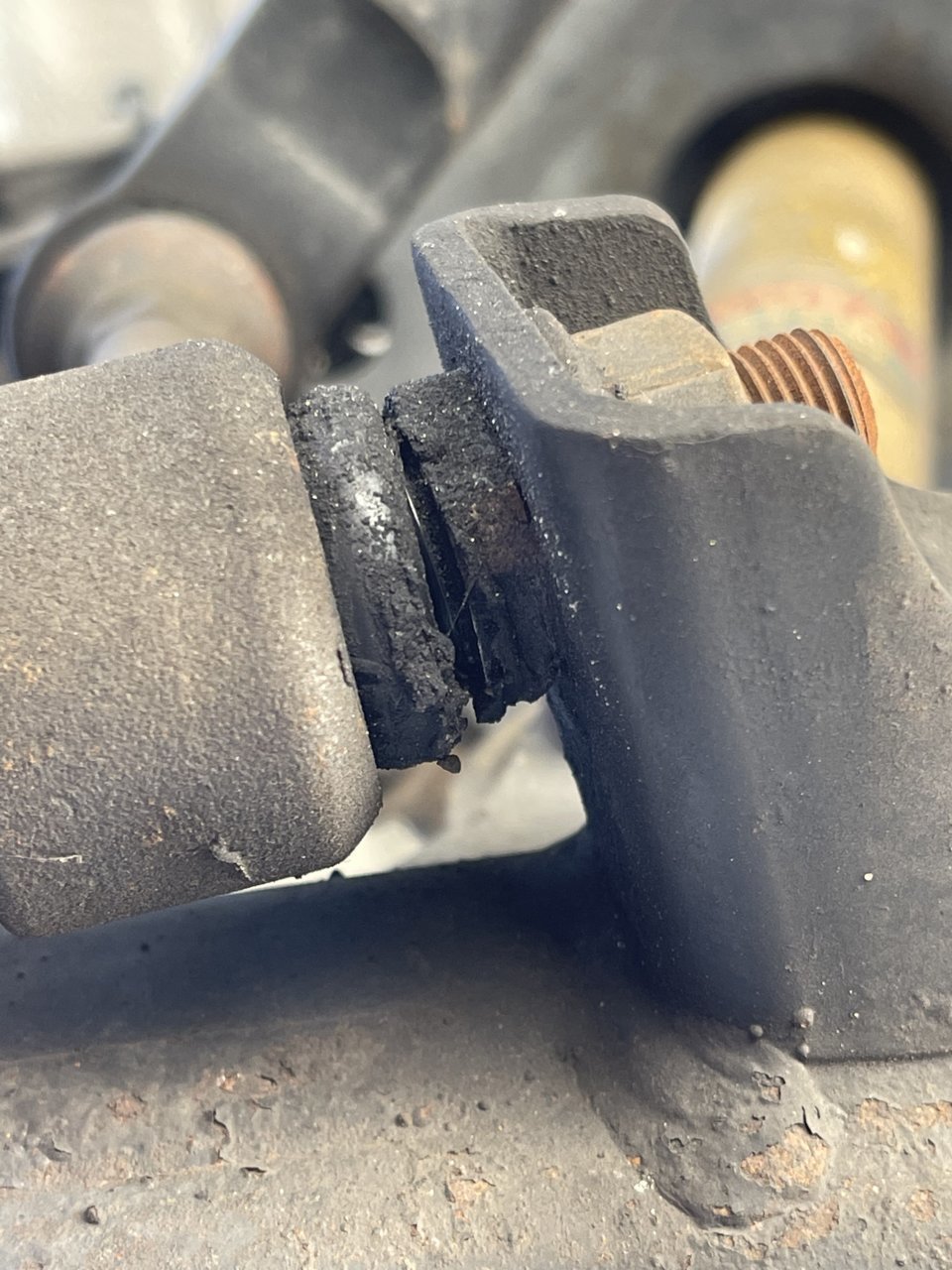

    Hi I have a 2012 tacoma v6 with the trd off road package 235k miles. Recently I've heard a loud popping sound that comes when I turn and occasionally when I step on the brakes. This sound doesn't come every time I turn or brake but atleast once everytime I take the truck out. I changed out the tie rods believing they were the cause but it still continues. What else could be the cause of this sounds. I noticed the saw bar link boots are ruptured, could that be the cause?

    Possibly. I had 1 leaking it’s grease, right rear. I was getting a clank noise over bumps. The noise went away after replacing the end links.

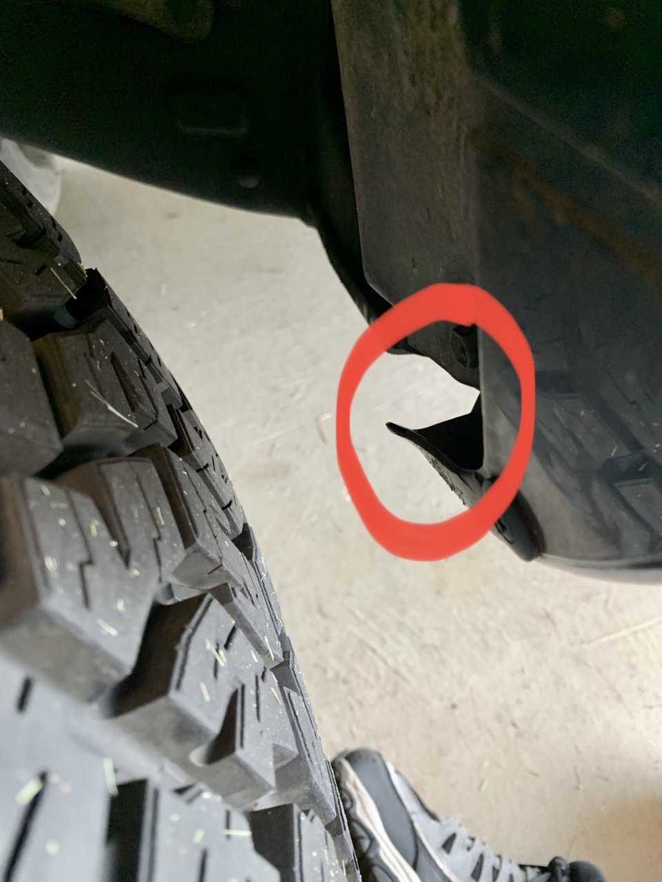

    UPDATE!!!
    Ok so, after getting the the truck on jack stands, I completed the 12&6 and 9&3 wheel check both on the ground and off the front tires. Solid as could be. (It was like 99 degrees outside which sucked dog balls). I inspected every ball joint, bolt, boot and tie rod for something damaged or has play in it. Nothing. So I decided I would try to replicate the angle of the tires were I would get this horrible grinding sound. Lmfao!!’ On the first try I got it. Stopped the truck and inspected the drivers side tire to see if it was touching anything, if cables where getting pulled …. Anything. So to my surprise, I found that the very bottom corner of the drivers side plastic guard was rubbing the tire only when the wheel was at just one specific angle and mostly in revers. Since I’d done the 2.5” lift a few months ago… I’d figured that the suspension had already settled. Did it take that long to settle or is there something else going on? Like this is a leading indicator of something wrong? Since it was such a small area, I put the heat gun to it and just bent it back a little out of the way. Not noticeable since it’s the underside of the truck. I could see where the tire was rubbing the plastic. After the adjustment… the sound is gone.
