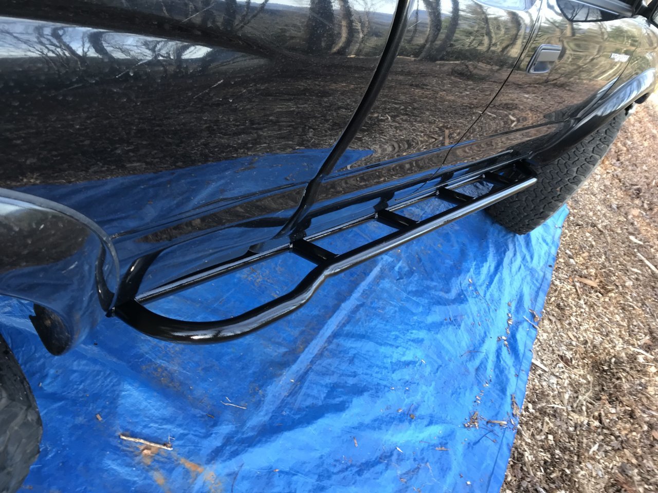

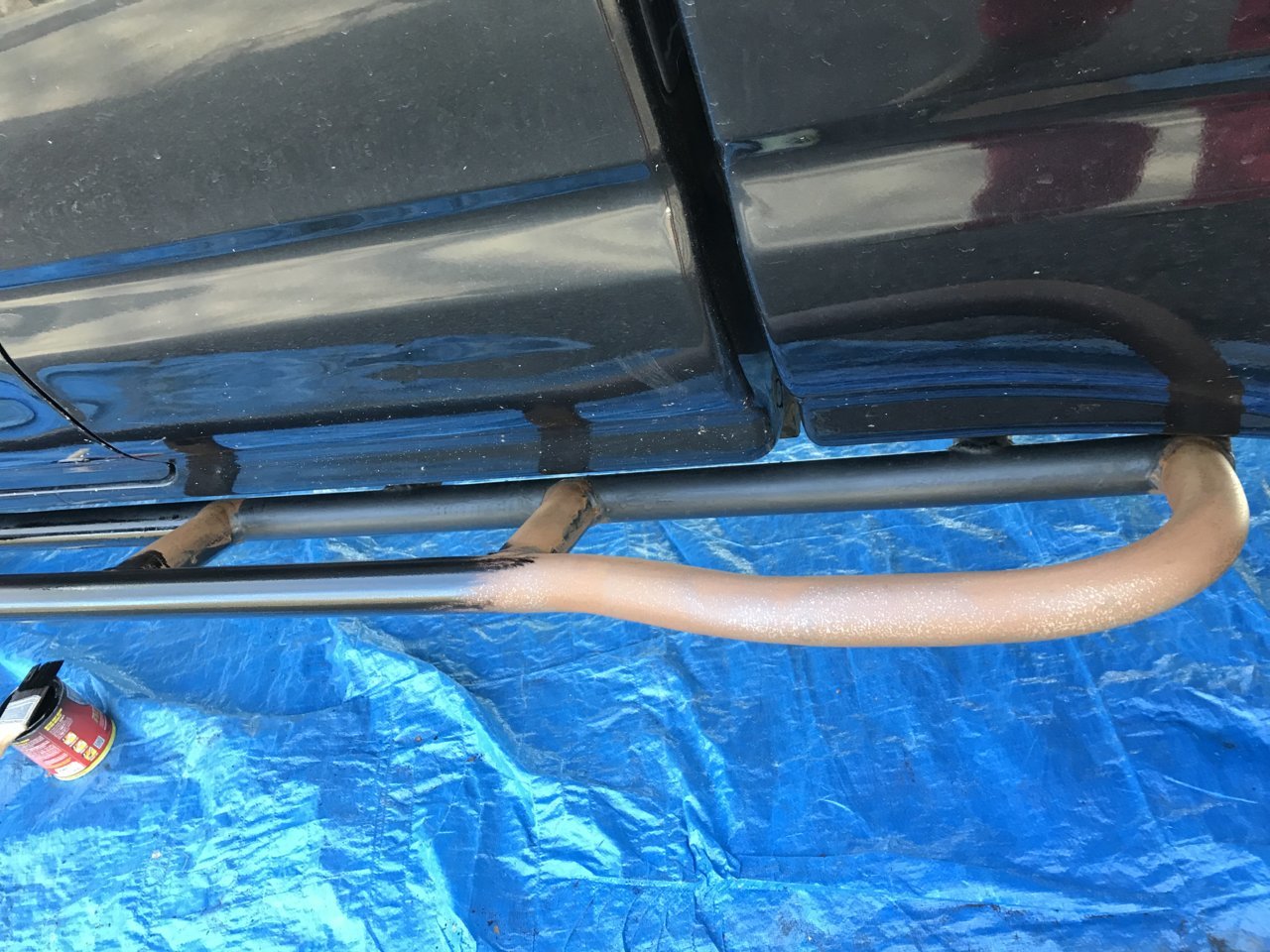

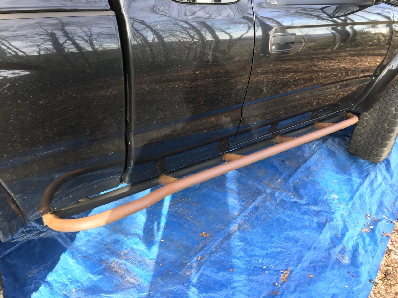

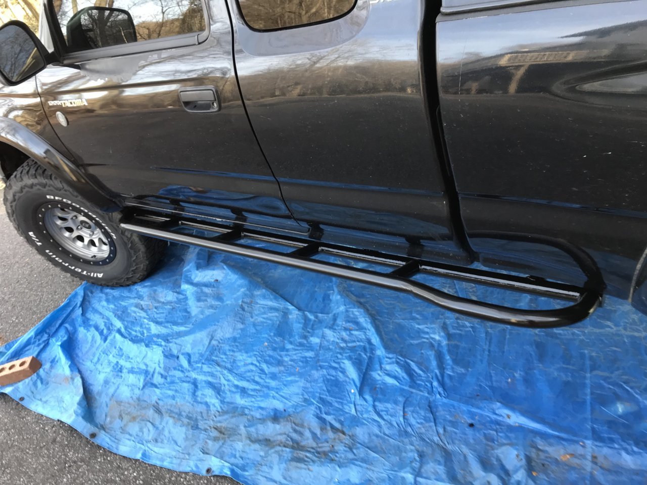

    I purchased a pair of rock sliders several months ago and threw a couple of coats of POR-15 on them. I noticed not too long after that the POR-15 started coming off in sheets. I removed all of it and let them sit bare metal for a couple of months as I was away on business. I knocked off the loose rust with a green scrubby pad and washed the sliders in soap+water. I let them dry for a couple of hours, wiped them down with a clean dry rag and applied the POR-15. From what I’ve read, it should bond pretty well to the rusted metal.

    Need to top coat . No protection from sun . They recomment if going to top coat when its alittle tacky yet to hit with dust coat of primmer so top coat has some thing to bite too.

    Looks nice :thumbsup:

    I have a top coat. I sprayed the oem black over it! :thumbsup:

    Makes sense. The part of the rock sliders that weren't exposed to the sun was still pretty well protected.

    As long as there is rust it will bond to it. My first application didn’t go so well. I did everything I was suppose to as far as applying it except put a top coat on it. The slider that was most exposed to the sun didn’t last very long.
