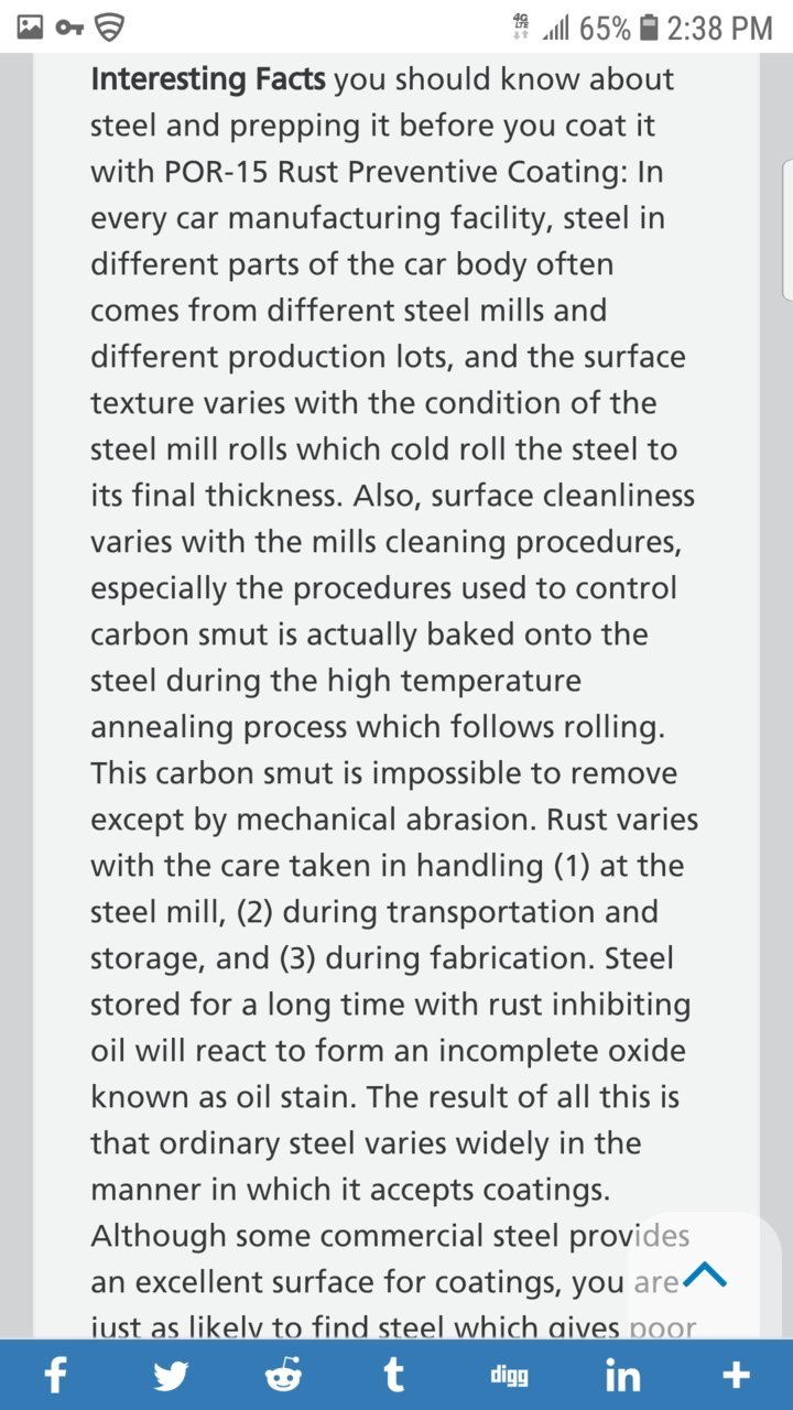

    Nah, me and a few guys in the lab did some tests on the stuff a few years ago out of curiousity, we were working in a green chemistry lab so i suppose its relevent? Basically we just wanted to fuck around with the stuff lol.

    Lol either way I appreciate the info. There is a ton of heresay and BS talk on multiple forums about the stuff with about zero consensus on what UV actually does to it. I’ve seen comments from UV just makes it look ugly to UV destroys it.
    It’s easy enough to topcoat and that’s what I’ve done on any projects where I’ve used it.

    Yeah if its poked away so only a bit of sunlight can get at it (some parts of the frame and other spots) it might just fade, but in direct sunlight it decomposes real quick, as op found out lol

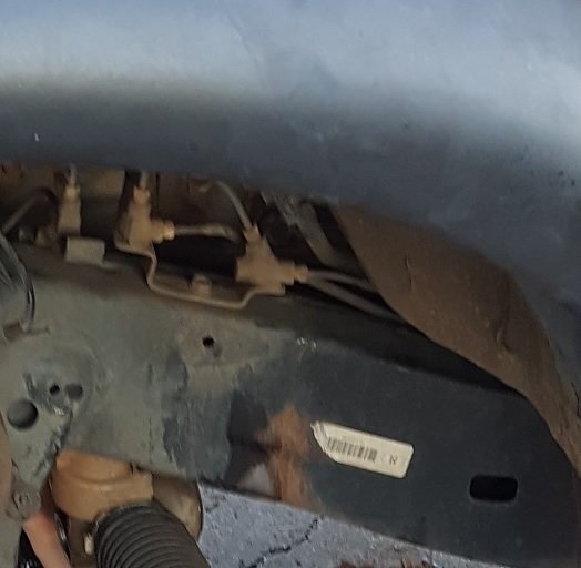

    I just painted my sliders with high temp BBQ paint. Holds up really well.
    (EDIT) Although, full disclosure, I do live in CA, where this is what happens to a frame after 6+ years of being completely unprotected from the environment:

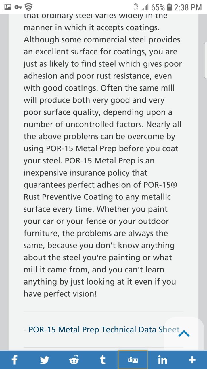

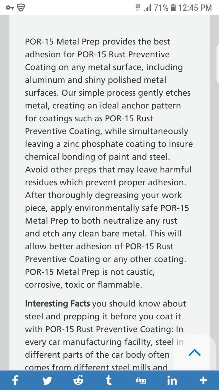

    Pretty much should use metal prep for por 15 to stick properly.On bare metal etches metal and on rusted metal leaves a coating on . Also a dust coat primer or paint before por15 dries. Once dry almost imposible to prep good for paint to stick .
    Follow @JdevTac advice and alls good .

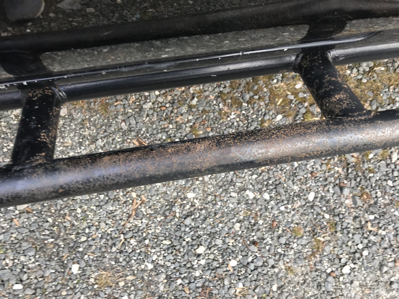

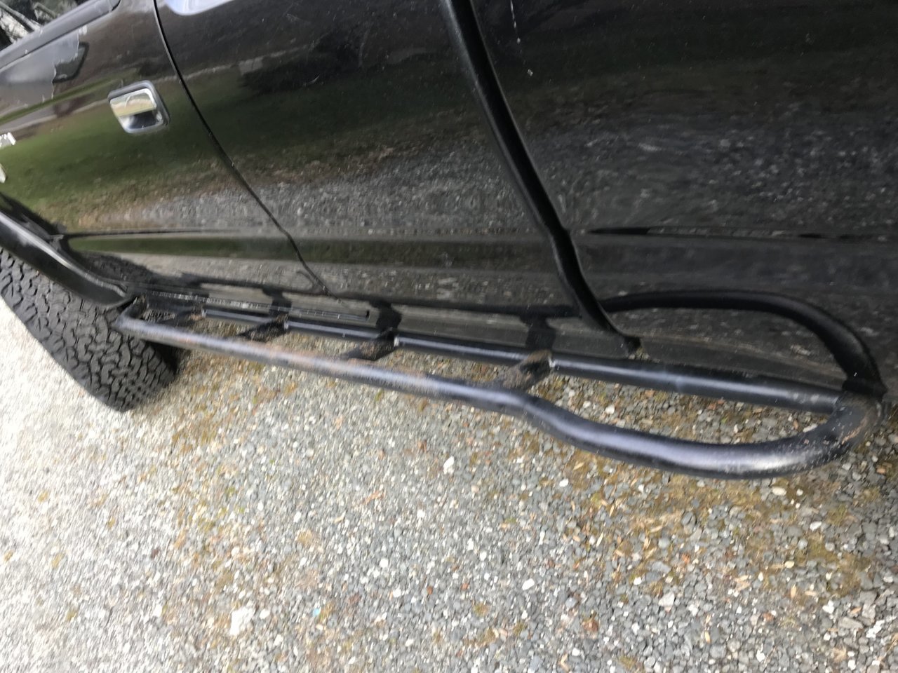

    These pics are as of right now. I do travel a lot and work near the ocean but I’d like for it to last longer. No big deal to wire wheel them and throw another coat on there. I may try another product to see how it holds up.

    Yep, the 1st time I did it, I didn’t put a top coat on and it’s started rusting through hence why the “take 2” post. This time after applying the por-15 I put two coats of OEM paint.
