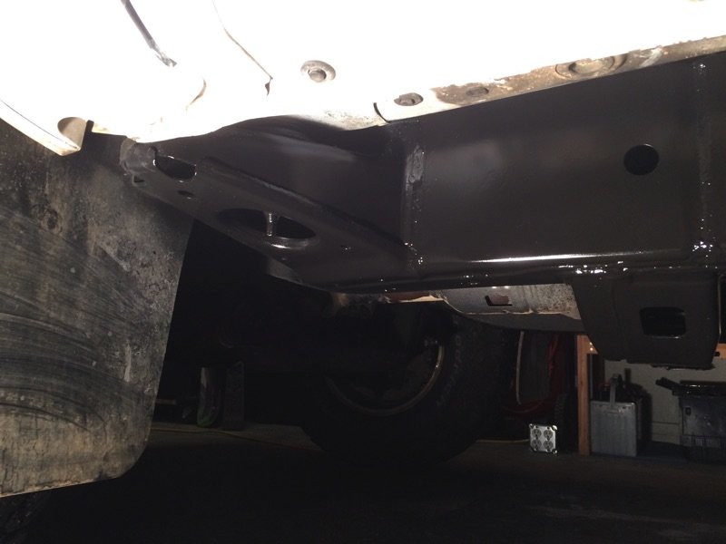

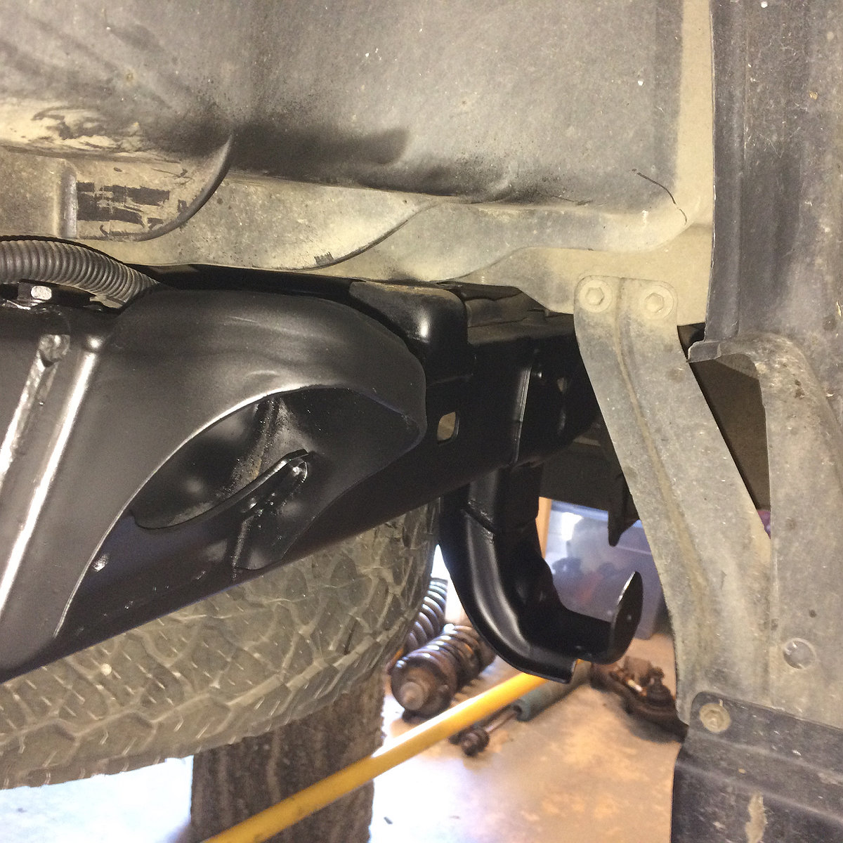

    I just finished up with a frame repair and POR15'd while the bed was off... my initial impression: I'm sold. I chose the semi gloss and I'm surprised how far this went, about 1.5 quarts for three coats of the back frame. The key is prep, but it's also only been a couple weeks.IMG_20171029_154533611.jpg
