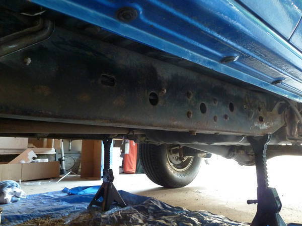

    The truck is an 06 Access Cab 4x4 TRD O/R. It's new to me. I was fully aware of the fairly nasty case of surface rust on the frame when I purchased it (private sale) but I did get under there during the test drive and bashed everything with a hammer and found nothing porous. I used it as leverage to knock 1500k of his asking price and decided to deal with the issue myself using POR15 rust treatment products. For the record I live in the Canadian prairies with tons of road salt so rust is a fact of life out here. I want to get the visible frame pieces looking a hell of a lot better but the real goal is to extend the life of my taco (which I am very happy with so far).

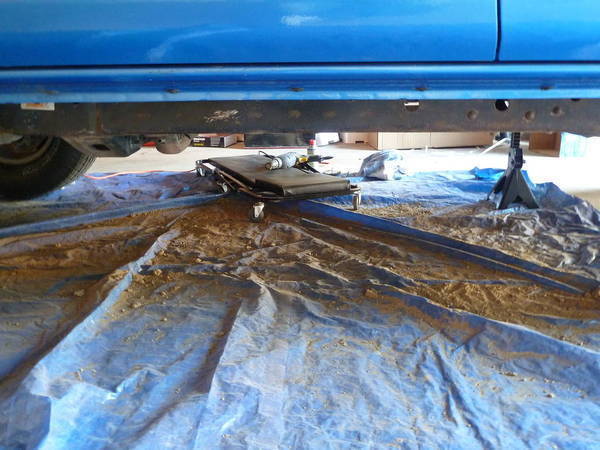

    Step 1 Degrease
    Get under there with a wire brush and wire wheel and grind everything down. While I was down there I also removed as much dried mud and rocks as I could from all the nooks and crannies (there was a ton of debris caught inside the frame rails).
    Here's what came off

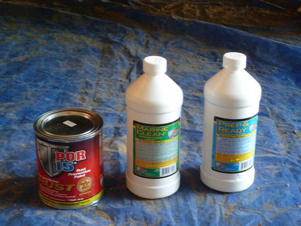

    POR15 uses a three step process involving a degreaser (Marine Clean) followed by a self etching metal primer (Metal Ready) and then the paint itself.
    The goods
    I bought a kit that included a quart of POR15 paint and a litre of the other products. The cost was $120 + shipping so I did my best not to waste any of this stuff. I diluted the Marine clean to about 1 part with two parts water in a spare spray bottle I had lying around. I proceeded to spray everything down

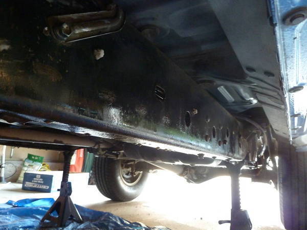

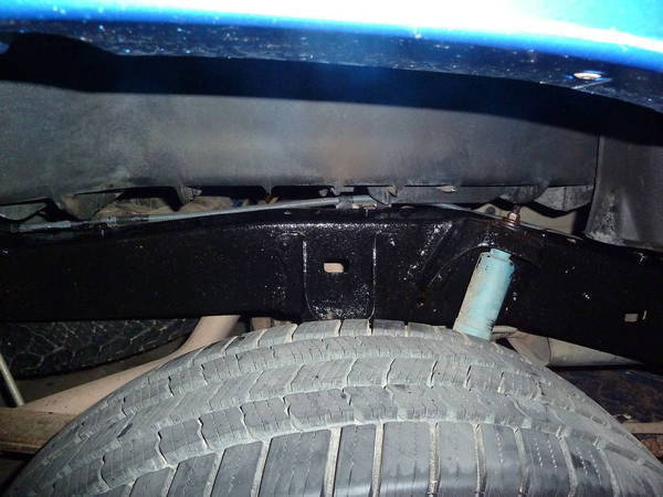

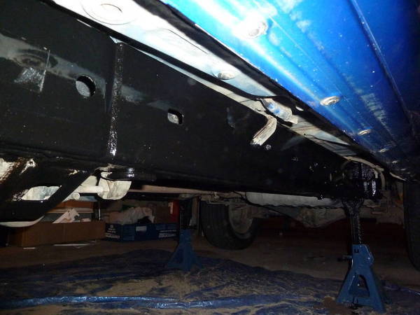

    The end result
    Overall I'm happy with the way it self leveled and how the finish looks. Time will tell on how it performs but I will update this thread as time goes by.
