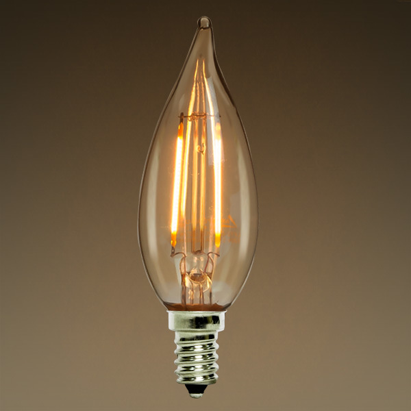

    Is it the candelabra style bulb like this?

    Nice, I will have to pull the fixture off this weekend and see whats behind it. It wasnt caulked so I can only assume the worst. The bulb I found was that new twisted LED style.

    This style or a regular lamp sized bulb socket?

    Regular lamp style, larger twist on.

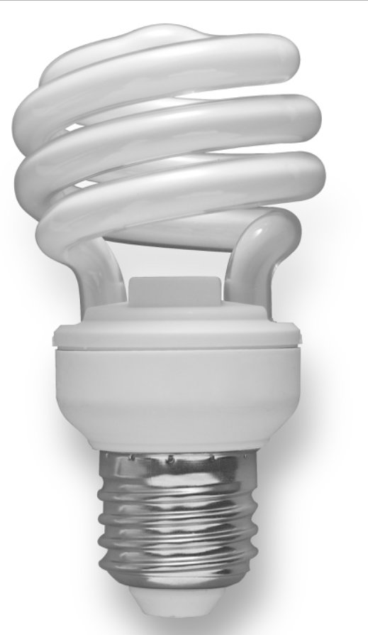

    47DD2474-D21C-452A-9953-E491A5132F18.jpg This type?
    This is a CFL or compact fluorescent lamp.
    As others have said, clean any corrosion to ensure a good connection, and remove the housing to make sure the wiring is connected properly.
