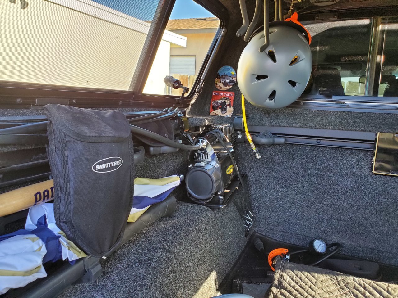

    I'm running the smittybilt unit at 5.65 CFM and this thing kicks butt. it also has a super long hose that I can use to air up my Jeep from my truck which is definitely nice to have. I also got the extended warranty with it just in case. I got it on sale for $130.
    Oh and by the way I wired it straight to my battery. It has its own circuit breaker built into it that you just switch the button if it overloads.

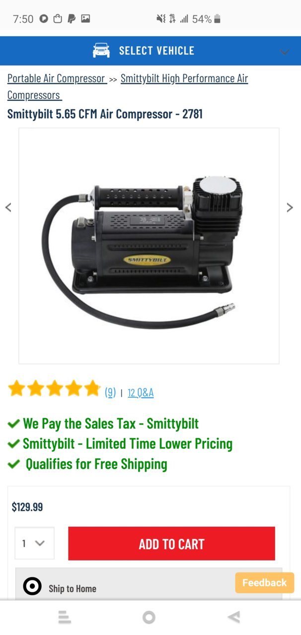

    This is the one I'm using. Nothing but good things to say so far about it. One of the guys I personally know at 4wheelparts also runs the same one and says he's had the same luck with it

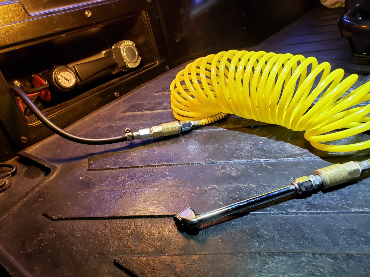

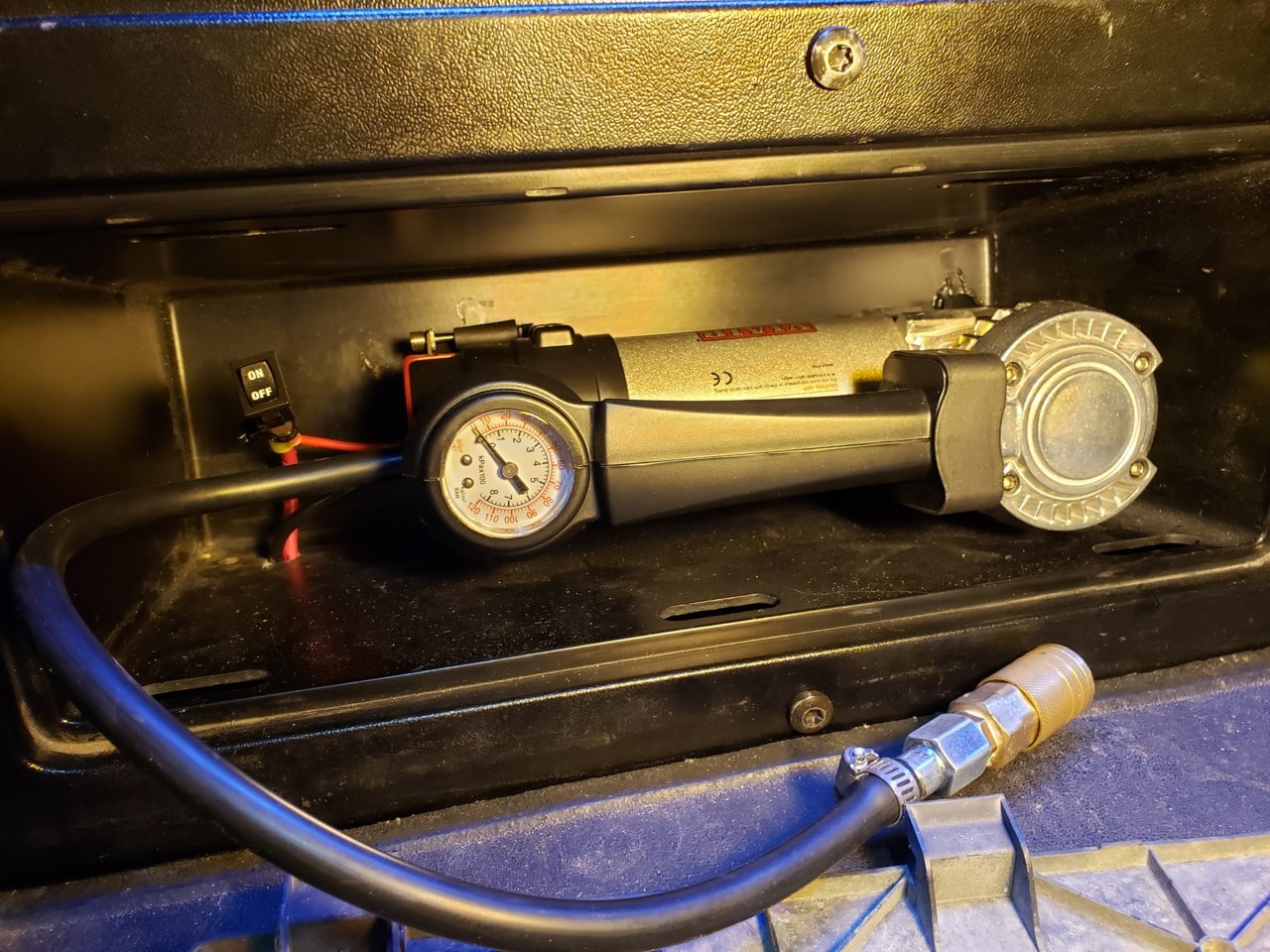

    I just got done installing the viair 88p in the bed cubby. Changed the wire out to 8 guage due to the distance from the battery to the bed cubby. Installed a different 20amp fuse. Removed the on/off switch from the compressor to make it easier to access. Then decided to cut the hose off and install a coupler.
    I probably should have bought the viair 400 since I basically modified the 88p to due what the 400 is already setup to do. But I was trying to keep the cost down and I'm running 265/75/16s. I'll probably be purchasing another compressor again in the future :spending:

    Saw a video & it’s looks euuuuge compared to the viair.. but it has 2x the flow as a 300/400p

    Was a big step up from my viair I used to run...but that was the 88p.

    Yea but where the “test” CFM isn’t the same place where viair test CFM. They test it from the internal flapper valve (instead of the end of the hose where viair tests it). I can tell you for a fact the 400P has the exact same fill times as the “5.65CFM smittybuilt. But that’s a great compressor too. Nothing bad to say about it at all!
