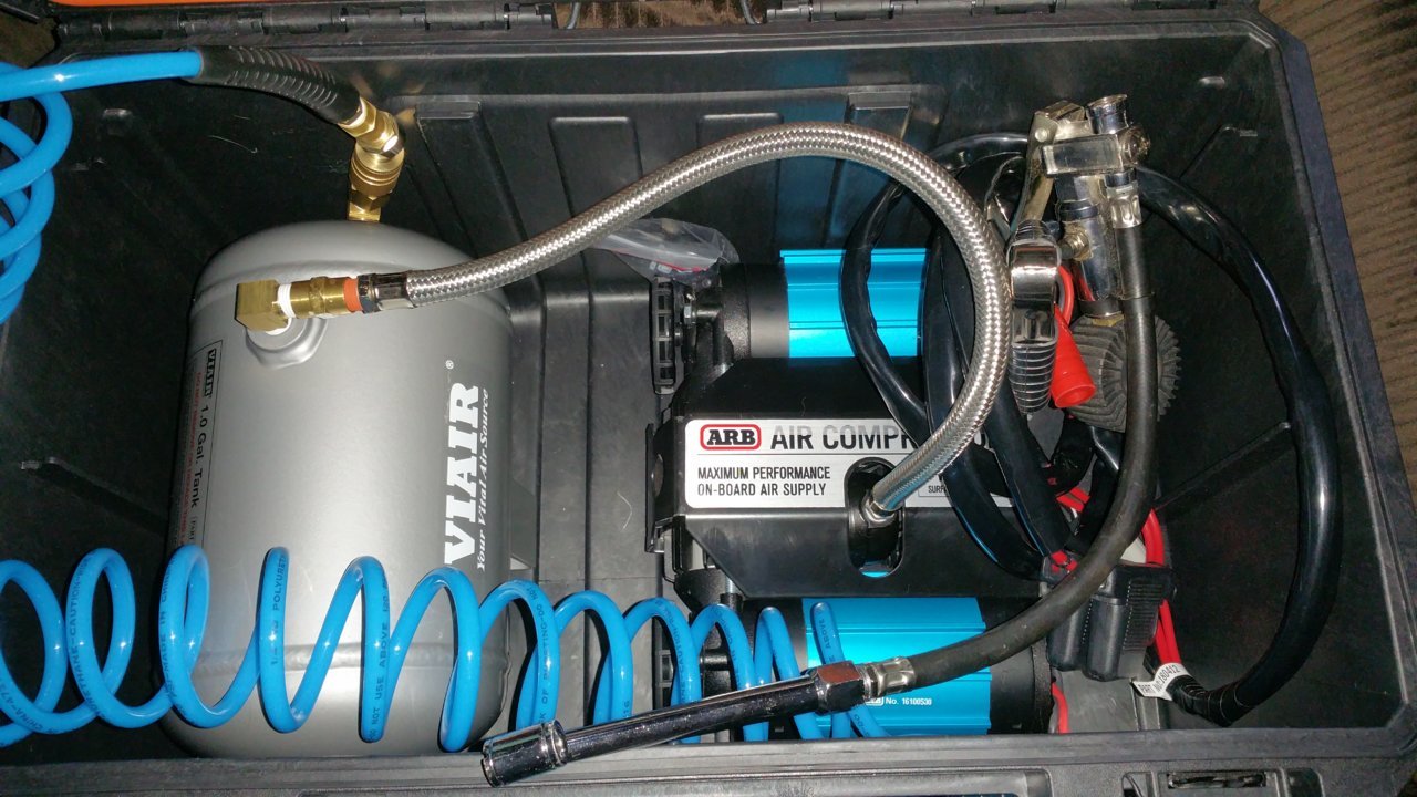

    I made my own portable air station. Yes, overall it was pricey but I use it often and it's handy when in a group who've aired down.
    maxtherat and xguntherc like this.
