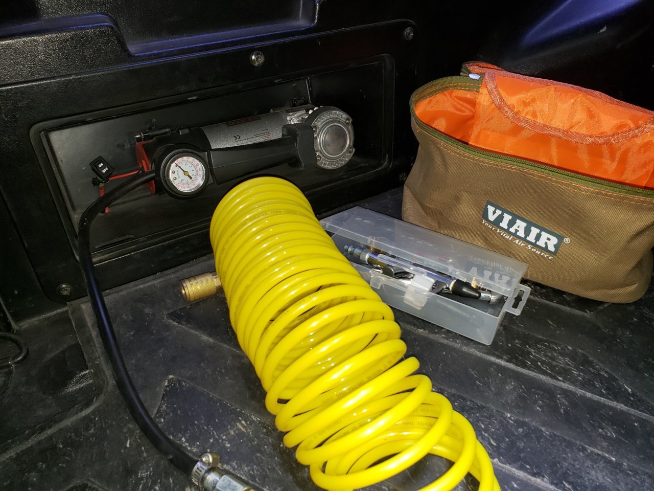

    I have the 88p. For me I couldn't justify spending so much more when I only use it occasionally to air down when going to the snow in the winter. The fill rates are pretty good. And I'm only running 265/75/16s (31" tires) so it works great for me.
    I installed it in the bed cubby of my 2nd gen. Ran bigger guage wire from battery back to compressor and left switch in line to turn it on or off from bed.
    I can hit all 4 tires no problem
    cricket1116 likes this.

    Very cool! How did you mount it in there? I’ve been looking to mount mine in the engine bay but back there would work too.

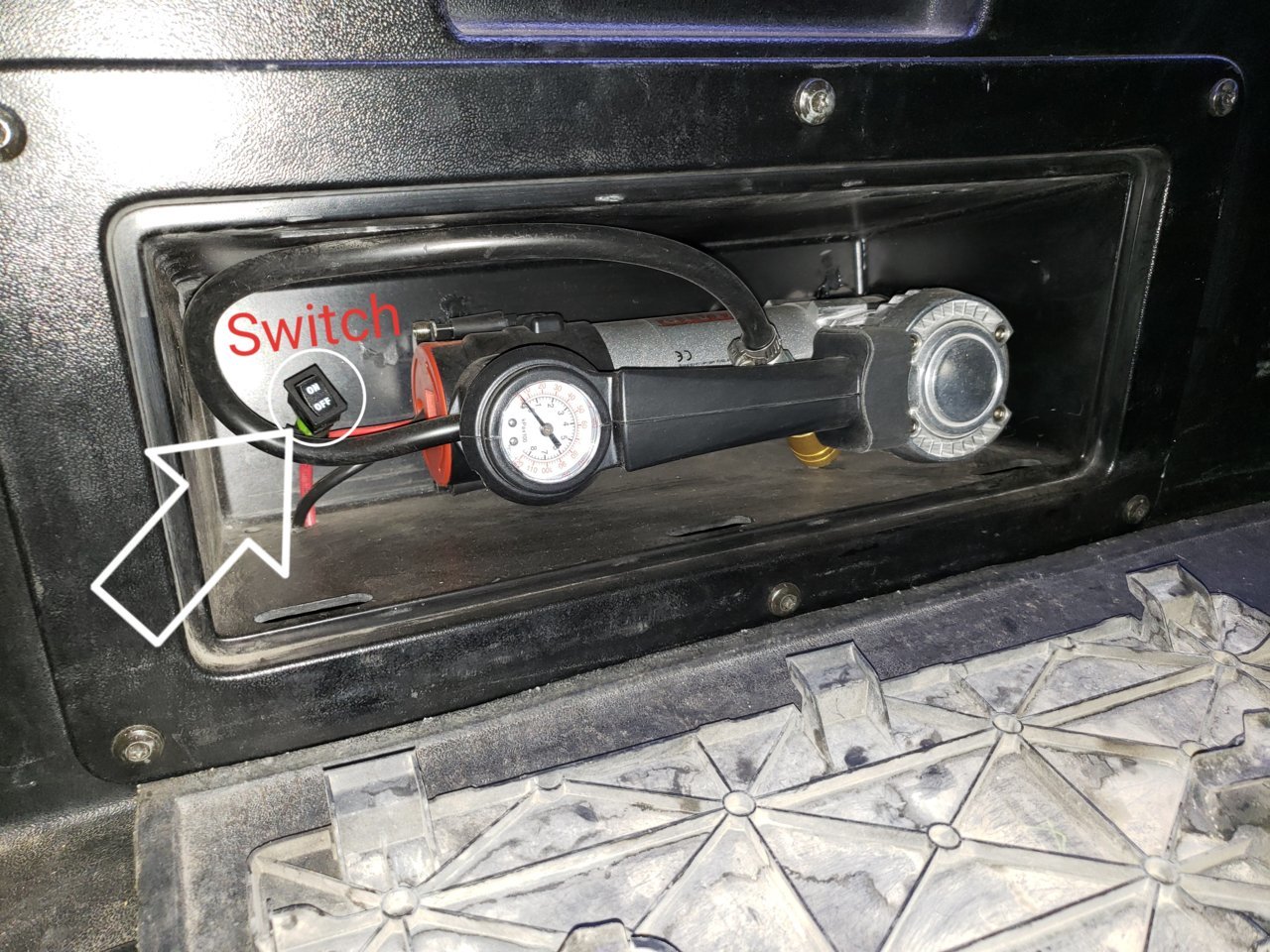

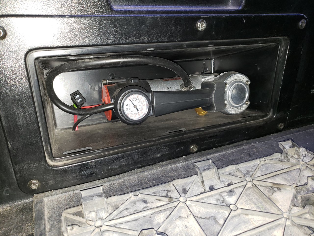

    I just pulled the bed cubby out and marked the 4 holes on the compressor on the cubby. Pre-drilled the 4 holes then drilled a hole for the positive wire to come in the cubby. Screwed the compressor in and re-installed the cubby. Ground wire is ran to the frame just under the cubby.
    Hard to tell by the pic but the compressor head is sitting off the cubby about a 1/4 inch because the compressor gets pretty hot.

    Did you wire in a switch? Or just leave it hardwired to the battery?

    Ya its hardwired at the battery then goes through the switch that came on the viair 88p. I just pulled the switch out of the compressor. It sits loose in the bed cubby (can be seen on the left of the compressor in the attached pic). I need to come up with a better spot for the switch but it's not causing any issues the way it is.

    Gotcha. I'll probably get a CH4x4 switch and put it in my last open switch spot inside the cab.
