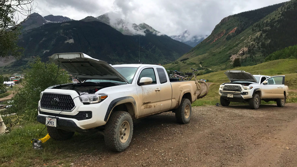

    Yes the 85P is 2-3x as fast as the cheapies on Amazon and in your local big box stores. It's also noticeably quieter. The 85P fits nicely in the storage bin below the access cab jumpseat without rattling.
    The engine needs to be running when you run the compressor. Else if the system voltage drops below 13V, the higher current draw will often blow the 15A fuse in the cigarette lighter circuit.

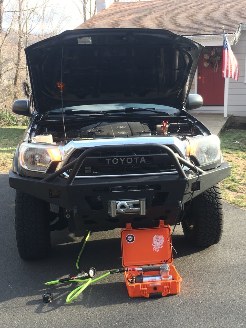

    I've used this Viair 300P for years -- fills up tires fast. Doing the homework for a possible upgrade to the 450P onboard.
