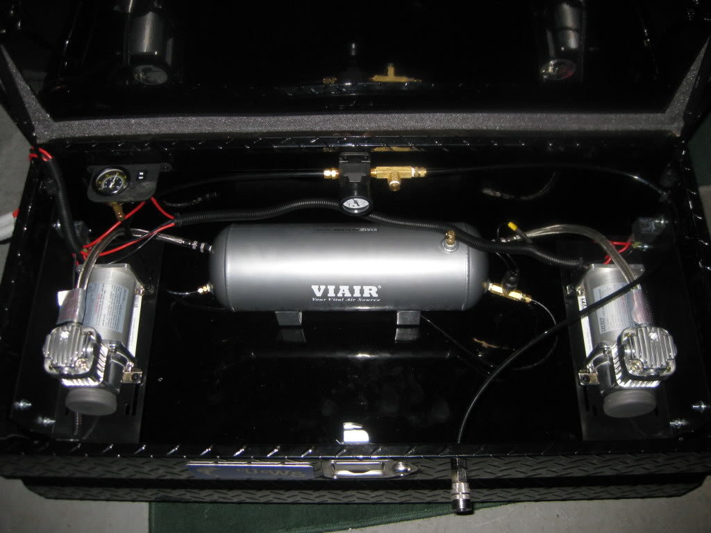

    I am in the market for a portable air compressor to mount under the hood of my truck. Google unfortunately isn't pointing them all out to me very well, and I stumbled on a site that has a couple of reviews of different makes. Great info IMO.. Curious about inflations times/ real world comparison.. check it out:D

    thats a nice setup DN!

    yeah, according to the comparison.. it was the fastest at 51 seconds.. but 200amps, Holy Shit!
    Wow, that looks kickass.. two because one wasn't fast enough? How long does it take you to Air up?

    Thanks Keason

    Call me simple minded, but I like the way DREW has his setup.. no holding tank, just straight from the ARB pump..

    It's the super duty kit (pn: 10008) offered by VIAIR. Heres the fill rates.
    more specs
    on average. I air down to 20 psi. going back up to 35psi takes, guessing, 1-2 min per tire??? I've never had a clock on it though...

    yep... wish my tank was bigger. mine will run air tools but it works the compressors like a 19th century mule. :deadhorse:
    (haha never got to use that one before)

    The newer ARB high output compressor performs much better than the ones they used in the test.
    If you're going to use air tools you'll probably want a tank and a compressor with a higher CFM output than what an ARB can provide. If you just want to air up your tires, then you don't need a massive compressor, just something that will get the job done and work consistently.

    sweet setup DN... a larger tank would be more effective, but its compact & works for you!

    Thanks. I like all the extra room still left in the tool box.
