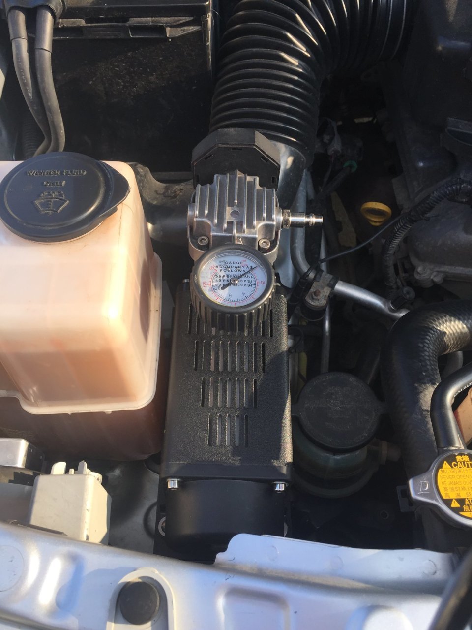

    Still going strong. It’s been mounted under the hood for almost 4 years now.
