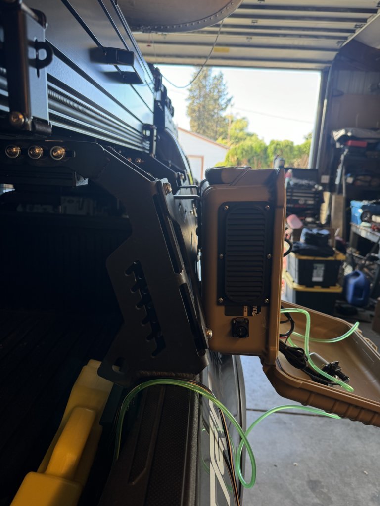

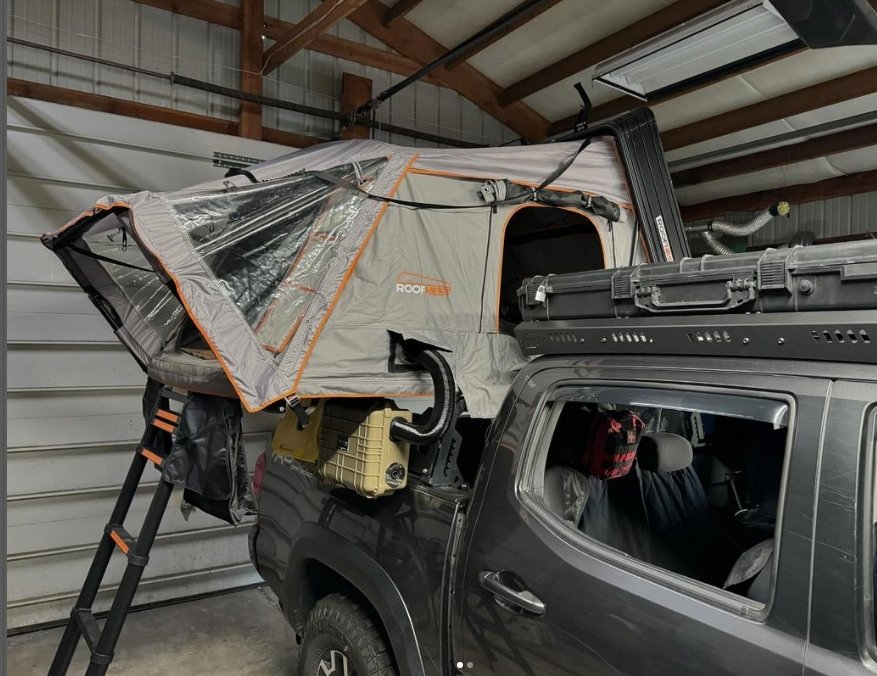

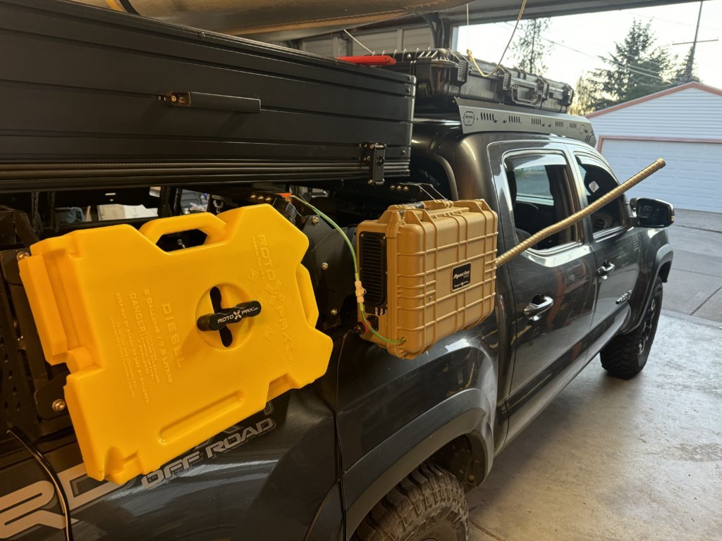

    Just finished putting together a diesel heater for my tent.

    How'd you mount the box to the rack? and aren't you worried about the heat from the exhaust and how close it is to the truck?

    I got one of the all in one metal box units and keep it on the ground, and have a long slinky foil clothes drier hose that works perfectly for running the heat into the tent from there. The sound of the heater is a little quieter being away from the tent.

    I added the little muffler to the exhaust and it stays out plenty far away
    the case has 2” J hooks on it so i just hang it off the rack. They allow the case to sit straight up and down.

    I changed all the fuel line out for the hard white style. The green line that comes with the vevor kit sucks
